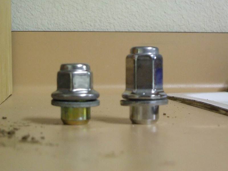

Re: Toyota Aluminum rim lugs
I'm not sure where you are getting your information but it's incomplete.
Look here : http://www.delica.ca/forum/wheel-size-b ... 13016.html
You can buy lug nuts Toyota OEM (flat lug centric with washer) both in shallow and deep shank as show in the picture below.
What you are referring to and others perhaps is the use of the short shank Toyo lug nut which will not fit on the long Mitsu wheel stud.
I have used that style rim with Toyo OEM long shank lug nut as it should be. Perfect fit.

jfarsang wrote: I have used that style rim with Toyo OEM long shank lug nut as it should be. Perfect fit.
Ok, thanks for the head's up Jesse. I have emailed a couple 4wd places in Calgary about an open end lug, if they don't carry those I'll see if they can get the long shank lug.
