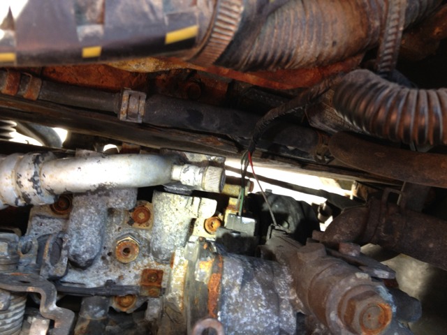

Hey guys,
Just got me a new toy, L400. Brought it from Vancouver to Toronto, melting my arse all 4500 km, since A/C issues. It seems kicking in, however doesn't lower temperature, just slightly cooler than ambient. All fuses are OK and fans are running. My question is where the lower pressure intake located, in order to measure freon pressure and recharge it, if anyone can post a picture it would be appreciated. I was reading posts, and took appart half of the dash looking for the valve, since got so much info in here that it is under the carpet on the passenger side. Before I take another screw out, please advise where that valve is located. Also, do I need to vacuum system before recharging, or it's compatible with the Red Tek available through CanTire?

Nowhere near the dash or carpet on the L400. The High and Low pressure charging points are located under the hood in the area near the battery. You can see them easily if you just trace the pipes from the air-con pump. They have light blue/greeny caps with 'L' and 'H' (if original).
The system takes 1.25 kg of R134a gas (assuming you have the dual front/rear system). Best to take it to an air-con specialist to have it vacuumed and refilled with the correct amount.
To confirm if the compressor is kicking in, you can just about see the centre nut if you peek down which should obviously be spinning when the clutch engages and still when not.

by lettereleven
Here is a Photo of the Low side port. It's in te engine compartment, kind of deep. Best to remove the intercooler (at least I found it easier)
Photo is from above- In the photo, front of van is on right, batteries at top and engine block at bottom.
Hope it helps

Thank, that helps, going to look her under the hood :-)
