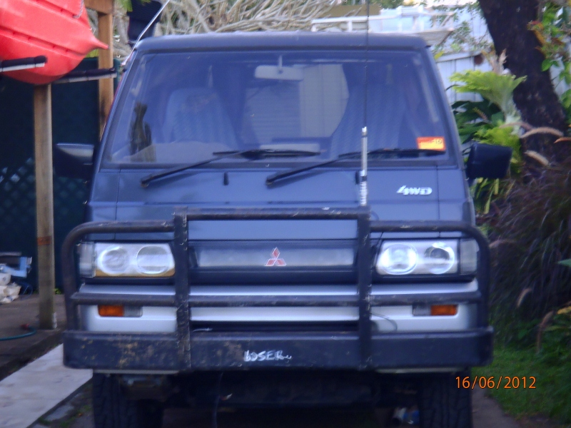

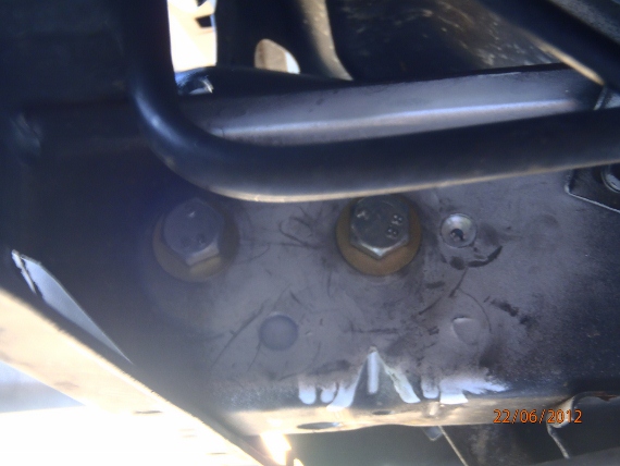

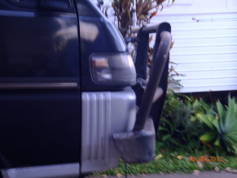

Any body looking to upgrade the old possum bar i found a 60 series landcruiser bar will fit nicely. Protrudes out the sides a little but sits at a nice height on the standard bar mounts. .Not mounted yet but i took my front bumper off and will be getting a few more brackets made which will attatch to the chassis rail and the bottom of the bar. It all lines up quite nicely with minimal work involved.

I like it,
Is it an aluminum bbar or steel?
FS

Post by gezzza »

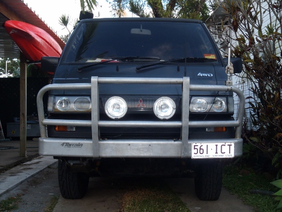

yo fs it is a alloy bar that was painted black but i have paint strippered it since then. Started working on it today grinding out the chassis rail holes. Will put some pictures up in a cupla days.
Re: l300 bullbar swap
That fits surprisingly well, with the lights lining up and everything. Good find!

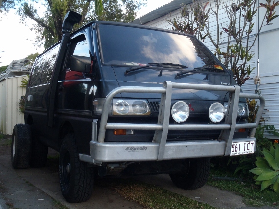

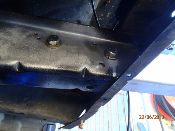

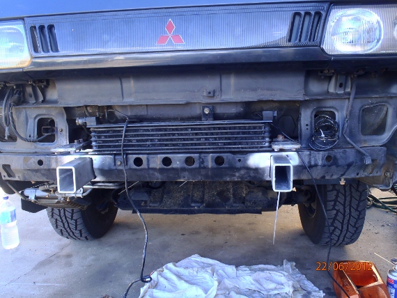

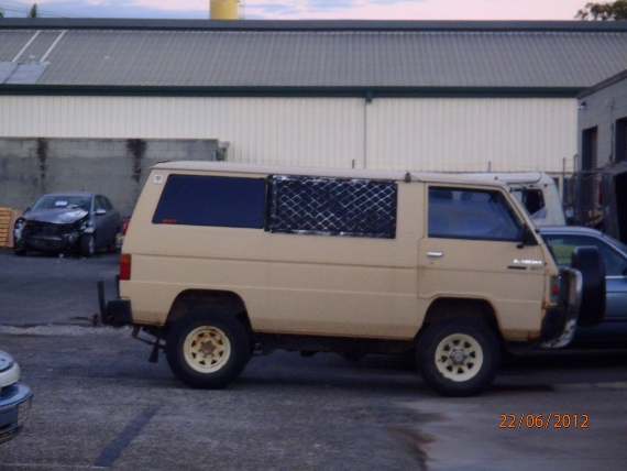

Its been done for a month now so heres some pics

heres my mates aussie l300 starwagon 1984 with commodore 3.8l v6 and hydrogen setup.
P6220260 (570x428).jpg (163.69 KiB) Viewed 6163 times
EXTENDED the chassis rails with 5mm  rhs steel
P6220257 (570x428).jpg (206.19 KiB) Viewed 6163 times
lrp374
Posts: 1023
Vehicle: 91 Super Exceed
Location: Kamloops
Post by lrp374 »
I'm interested in your dual rear wheel setup. Do you have a standard L300 rear end?
gezzza
Posts: 48
Joined: Sat Aug 27, 2011 8:21 pm
Vehicle: 92 exceed
Location: gold coast australia
Post by gezzza »
Sorry mate that is my spare tyre sitting there because its to big to go back underneath.Now i gotta kart it around in the back.
