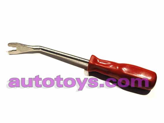

What is the correct tool for removal?

it looks like a forked flat head screwdriver

Post by jwfchase »
Posts: 5984
Re: Rear hatch problems
That's a tool I should get. Plastic sticks are limited in this application, to be sure!

Post by shealy »
I have that tool in my kit in the back of my van. It's come in handy countless times! Probably the quickest and easiest way to take off a panel without breaking anything.
Well not just only for door panels but also for the clear acrylic cover that attaches to my shroud on the bambi bars to protect my fogs. There are four plastic rivets that are tricky to get to, as they are inside the assembly and I end up spending forty-five minutes getting them off. It's a tool that I have been meaning to purchase for the last couple of years but I forget until I decide to clean my shroud and then I remember but now everything is in pieces so I have to finish the job before I go to get the tool; once I've finished the job I have other things to do so I'll get it later, when of course I forget and then I repeat the whole process. Perhaps I'll tattoo it onto my forehead so the next time I happen to be in Lordco they will see it and suggest to me to buy the @#$% tool...
