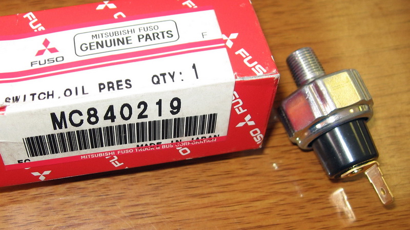

OK, in your case you can use the part shown below )which I have already posted in another thread) or any cross referenced one. I paid $18 for an aftermarket one in Lordco which I concider a ripoff. The genuine one should not cost more than $25.
- MC840219_resize.JPG (147.58 KiB) Viewed 7936 times

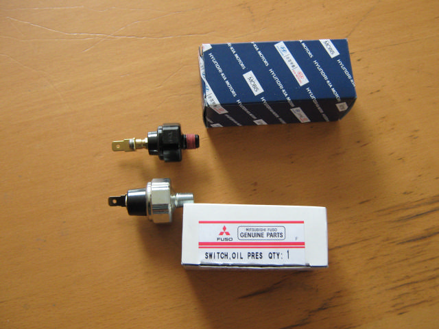

We have both Hyundai OEM and Mitsubishi OEM in stock.str8gooods wrote:I am assuming that a Mitsu dealership here would not have this? Should I just purchase online?
Steven
- IMG_1089.JPG (91.38 KiB) Viewed 7891 times

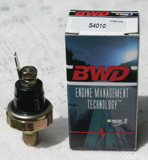

I am sick and tired of these sales ads. Here is my Lordco one which I have posted before. DO NOT spend more than shown below on the switch .
PS. FUSO dealers did not have it when I needed it.
- IMG_0007JPG.JPG (81.17 KiB) Viewed 7884 times
- S4010.jpg (95.6 KiB) Viewed 7884 times

OP has a hard time to source OEM part here and probably most people are curious about local availability.Profister wrote:I am sick and tired of these sales ads. Here is my Lordco one which I have posted before. DO NOT spend more than shown below on the switch .
We have two OEM parts and my post is definitely not a sales ad.
You can bring it for OP if you want.
The Lordco part you post is from China.
There are $5 switch and $55 switch in the market.
You will get what you paid for.
Be mature.
Steven

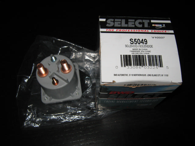

** ( another example ) Here's another 4m40 alternative starter relay made in China sold by Lordco at $40 something .
If you use it with modi ( lots of labour ), it may last a few days.
What a waste of money!

- 4M40 relay (2).JPG (84.55 KiB) Viewed 7879 times
