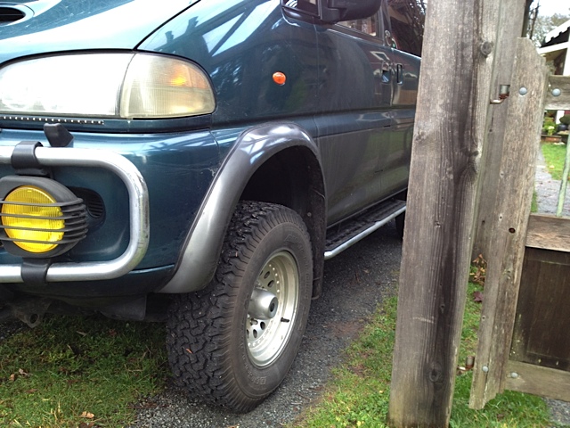

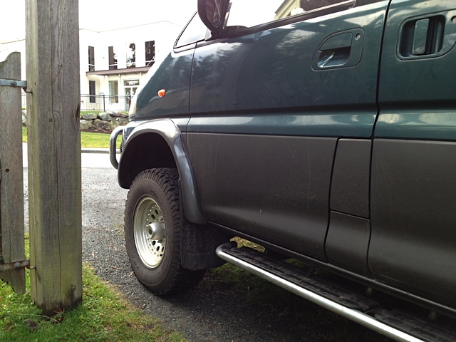

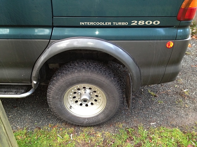

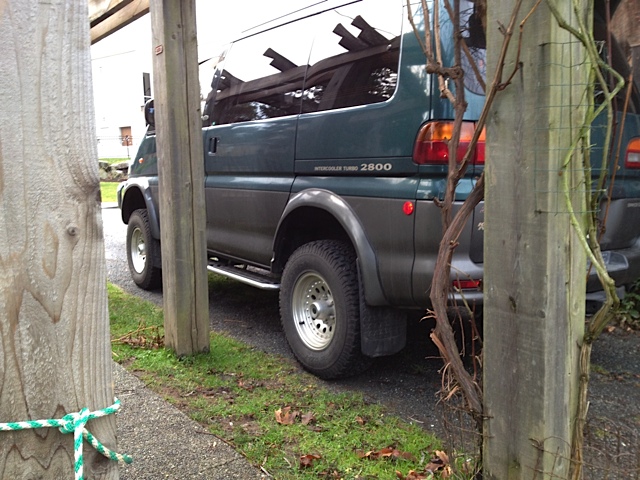

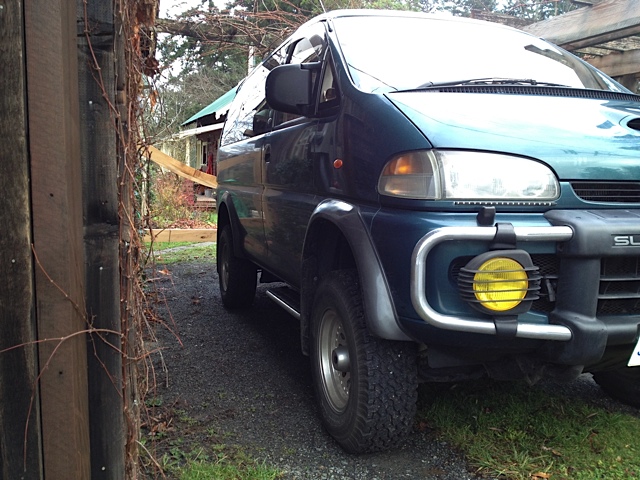

Some pics here only minor cursing required http://www.delica.ca/forum/looking-for- ... 63-15.html
I'll take some fresh pics with new rims and flaps in a couple

Rik
Your fender flares look great. Nice colour matchup.
Wayne
TLGF
Wayne
TLGF
