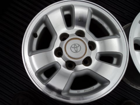

I recently acquired some sweet Toyota Tacoma 15x7 rims and was wondering a few things. The rims appear to be the same as what Delicat put on his van, and painted black.
I even have the same tires as Delicat 30x9.5R15 BFGs.
My van cam with aftermarket rimsm (15x6), so I am not sure how they compare with original. They are pretty beat up and oxidized so I want to replace them.
I think my van might have a small lift but I am not sure. I only have liquidmonkey's van to compare to.
So, I know they will bolt on (bolt centric), but do I have to modify anything?
Here is the rim.

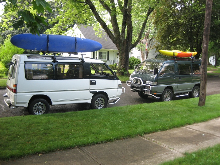

Here is my van (the green one) with Liquidmonkey's machine too.

By the way, that pic is of the first "official" eastern Deli-meet. We drove from Fredericton to Campobello island, through Maine, for a some lobster and a kayak to look for whales.

Here are a few pics of the new wheels. Again, they are tacoma 15x7 rims, probly off a 2001-2004, I am guessing.
