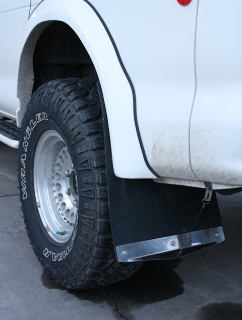

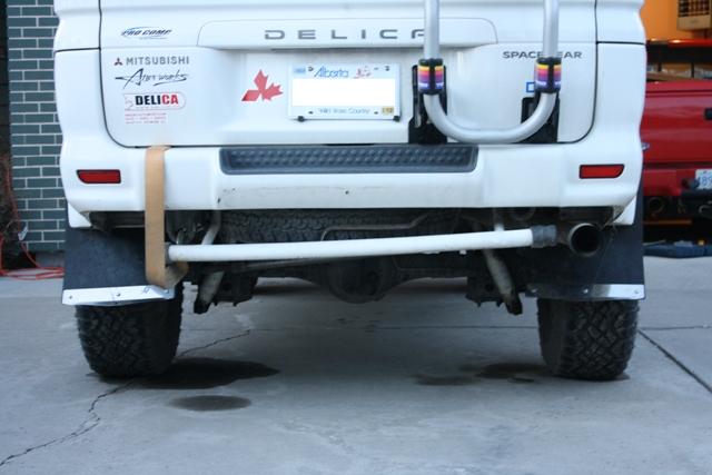

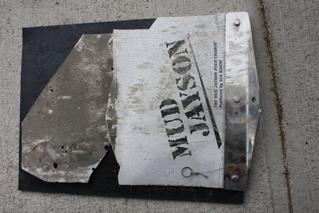

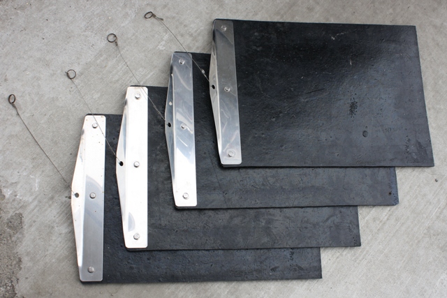

Got my rear flaps installed this evening. The hardware would not be difficult to make. You could also use aluminum for the bottom plates, the wire can be stainless fishing leaders and the eye on the end is a simple key-ring style ring that twists onto the bracket at the back. Here's some pics. You can see how craked the original flaps are. Please ignore my bent bumper... was rear-ended last week and will be fixed soon.
original flap laid over new plain black flap.
original flap.JPG (198.95 KiB) Viewed 5072 times
New flaps cut to size and hardware mounted.
new flaps.JPG (156.87 KiB) Viewed 5072 times
Rear passenger side installed!
Rear flaps complete!

Crap, those look good. Very hard to tell they are a home job. Where about would you get the aluminum for the plates?
