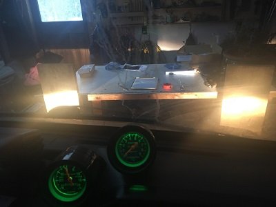

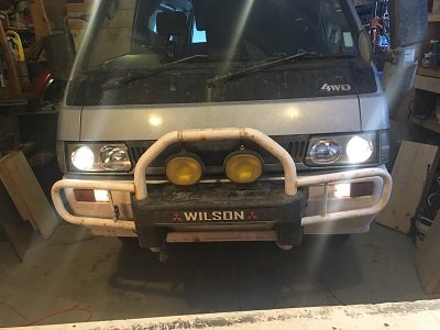

Installed new headlights. The old ones were cracked and the chrome interior had dulled, which I had spray painted with chrome paint to try to fix but it was not ideal. I bought these https://www.crazythegod.com/car-brand/m ... i-lhd.html. I thought about the LED versions but I really don't like the look and they are $100 US more expensive...
Old lamp brightness:
old lights.jpg (19.21 KiB) Viewed 52472 times
New lamps:
new lights.jpg (16.66 KiB) Viewed 52472 times
So shiny
new lights on.jpg (25.91 KiB) Viewed 52472 times
I'll aim them tonight... :)

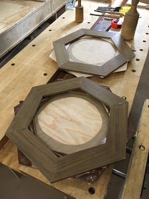

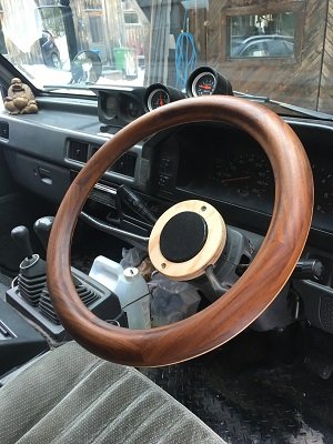

Took some time in isolation to finish up a wooden steering wheel I started over a year ago...
I'd glued up a couple of blanks for turning
wheel A.jpg (30.23 KiB) Viewed 51340 times
For front and back halves
wheel B.jpg (29.26 KiB) Viewed 51340 times

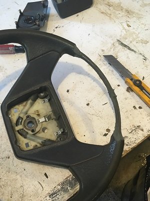

Peeled off all the rubber and plastic from the steering wheel
wheel C.jpg (31.07 KiB) Viewed 51340 times
and painted the internal frame
wheel D.jpg (21.33 KiB) Viewed 51340 times

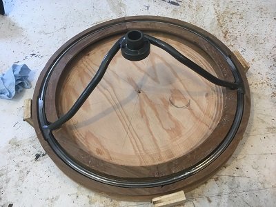

and routed a groove in one half for the frame to fit in
wheel E.jpg (35.37 KiB) Viewed 51340 times
wheel F.jpg (33.42 KiB) Viewed 51340 times

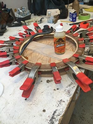

...glued it all together with Gorilla glue
wheel G.jpg (37.96 KiB) Viewed 51340 times

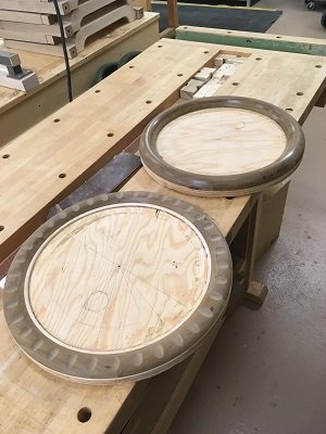

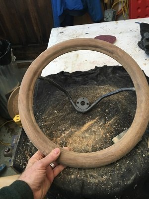

sanded it nicely
wheel H.jpg (35.03 KiB) Viewed 51340 times

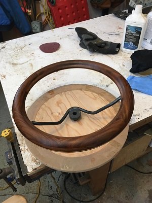

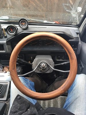

oiled it with tung oil and a coat of wax
wheel I.jpg (33.49 KiB) Viewed 51340 times
wheel J.jpg (35.99 KiB) Viewed 51340 times
And a prototype horn...
wheel K.jpg (36.17 KiB) Viewed 51340 times

That has to be your best project to date!! I think even Growler would be really impressed. Great use of your spare time. What's next it seems we will have a few months left to isolate.

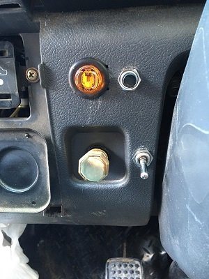

I found some switches and an LED marker lamp in my box of odds and sods...
so, I made up a glow plug ECU bypass switch just in case the ECU dies, as they are known to do...
Tapped into the 12v relay:
glow plug 1.jpg (31.21 KiB) Viewed 51282 times
and used the wire I'd run to the dash for the previous parasitic draw disconnect, now redundant.
I wired in an indicator lamp and a toggle switch to turn off the circuit unless I need it, (just for fun)
glow plug 2.jpg (31.39 KiB) Viewed 51282 times
The lamp illuminates regardless of if the toggle is on or off, so basically it is a momentary switch that turns on a lamp! :-D
glow plug 3.jpg (18.71 KiB) Viewed 51282 times

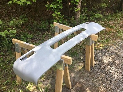

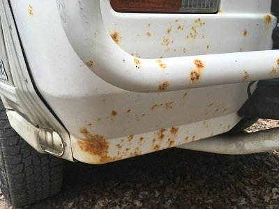

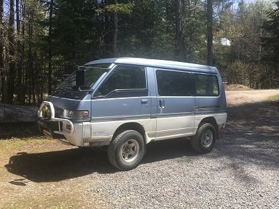

Another Covid project I've been meaning to get to: Paint!
Some rust has been appearing all over, mostly the bull bars, front bumper and wheel wells.
I pulled off the parts I could and stripped and primed them.

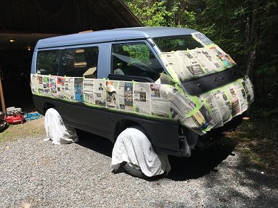

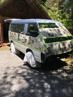

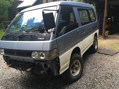

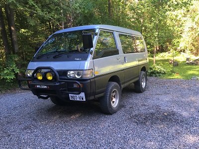

...masked off the van
and sprayed Raptor Bed Liner...
Its a two-part polyurethane truck-bed liner. $199CAN for 4 litres including the spray gun. Easy to apply, very little over-spray. You really have to be meticulous about your prep work. Lots of washing, degreasing and scuff-sanding.

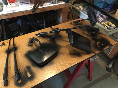

I cleaned up the mirrors and wiper arms with a Tremclad spray-bomb while I was at it.

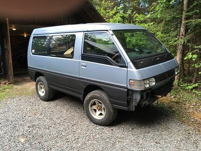

I'm very happy with the result. I'm interested to see how it holds up over the next few years...
All re-assembled...
Before & After
(Replica Japanese Plate from https://www.customjapaneseplates.com/)

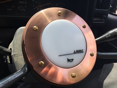

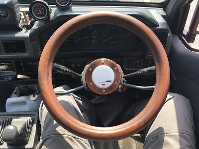

Finished up the horn button. A little Ipé, a little copper plate, a little bit of Corian counter-top material.
I lasered in the MMC logo and filled it with epoxy mixed with Ebony sawdust. :-D
I dig your style.

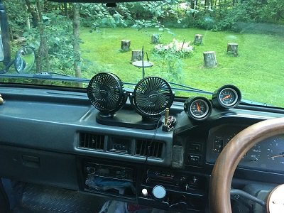

I picked up a few 10ftx2x6's last weekend and broke the altimeter/tippy-over gauge pod off it's moorings...again...
and my AC crapped out this season, compressor is seized...
so this is my new set-up:
$40. solved two problems. (I'll hang on to the pod gauges and fix them someday...)

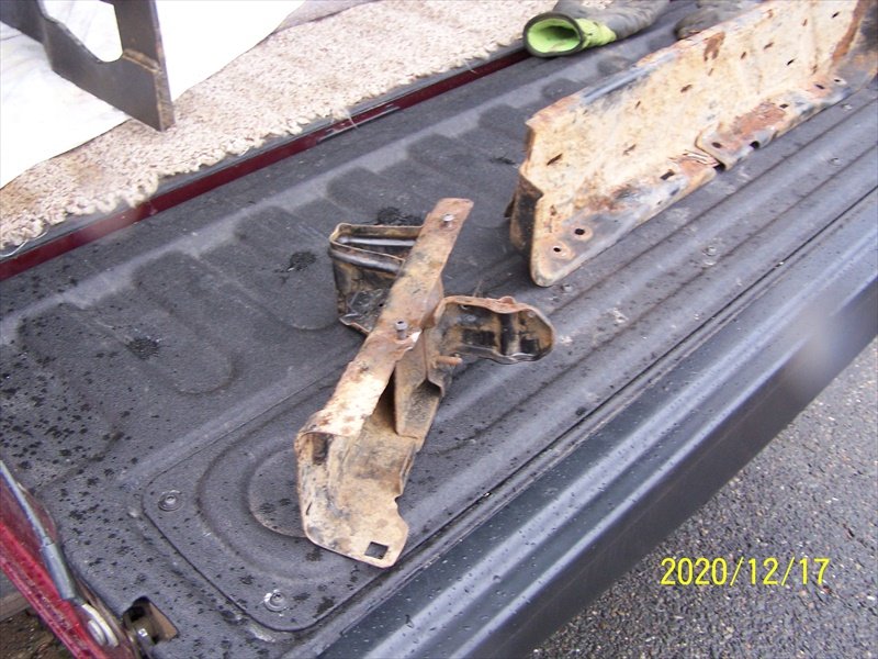

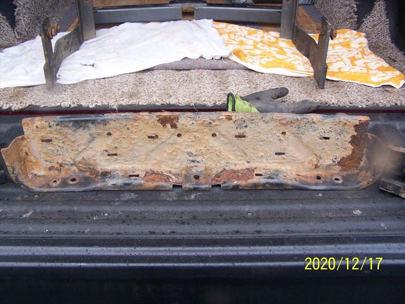

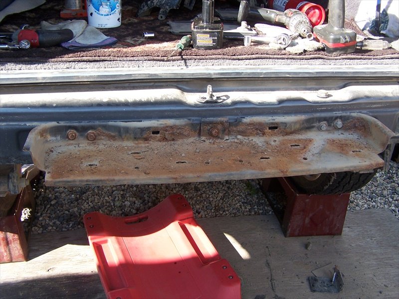

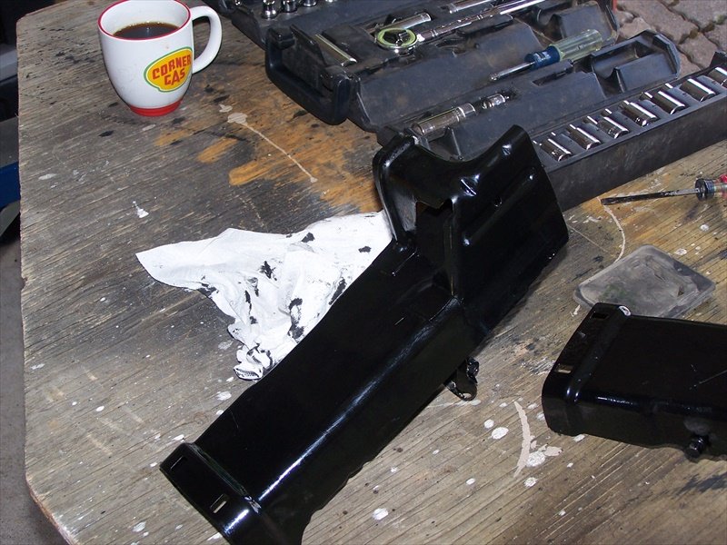

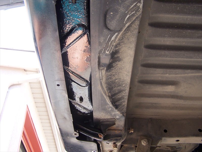

In July 2014 I took off a rusted rear bumper and figured to solve the problem for good buy removing the rust and painting it with POR-15 the king of rust paints! I was looking for rust in other places this fall ( I hate rust ) and found the underside looked rusted again. After taking it apart this last week I was right. It's to cold to paint outside so I've taken the pieces to be power coated. Hopefully it will last @ least 5 or 6 years. I put in a trailer hitch in 2015 and had it powder coated. It still looks good as the day I put it on. Results to follow next year.
Rear step 2014
Rear step 2014
Underside of rear step as found 2014
New POR-15 August 2014
After 6 years of POR-15
