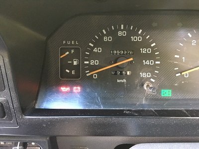

The oil light crapped out on me this week. Flickered on and scared the crap outta me and then went off. I pulled over and checked the oil level: all good. So under the van I went yesterday and reconnected the wire, also the 4WD indicator wire 'cause I was under there anyway. All good :)

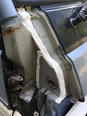

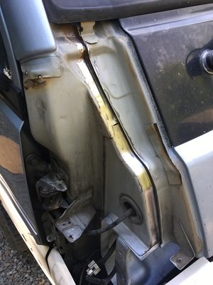

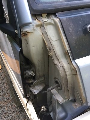

I also noticed a puddle in the passenger area after a hard rain a couple weeks ago, after installing the rubber flooring. I guess its always done that but just soaked into the carpet before now. So I tackled the front panel leak issue.
Old caulking
Water leak 1.jpg (29.52 KiB) Viewed 25775 times
Scraped off
Water leak 2.jpg (32.63 KiB) Viewed 25775 times
Rust cleaned off
Water leak 3.jpg (27.96 KiB) Viewed 25775 times
New Butyl sealant
Water leak 4.jpg (28.28 KiB) Viewed 25775 times
I used this stuff
Water leak 5.jpg (28.04 KiB) Viewed 25775 times

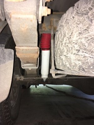

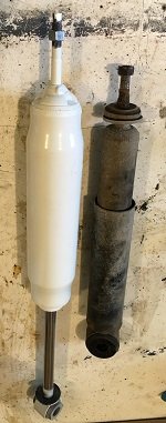

Installed new rear shocks today.
Procomp. (I have no idea what the old ones are...whatever they are they were DONE!)
Sexy! (Canadian colours!)

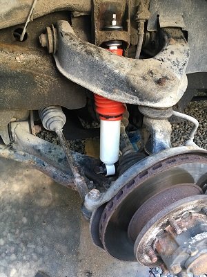

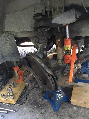

Got the front shocks on today! (also sexy :-D )
Front Shocks.jpg (41.41 KiB) Viewed 25310 times

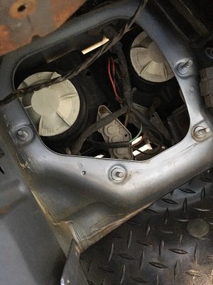

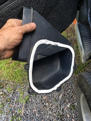

Today I am hunting down more footwell leaks.
The fresh air intake (easier done with the glove box removed)
Rain Leak2.jpg (26.53 KiB) Viewed 25160 times
Rain Leak1.jpg (39.33 KiB) Viewed 25160 times
and the windshield washer posts:
Rain Leak3.jpg (17.8 KiB) Viewed 25160 times
Too bad the super-duper sealant isn't black but I'll repaint the whole area someday...
Water leak 5.jpg (28.04 KiB) Viewed 25160 times
Big rain coming Wednesday, says Environment Canada...we shall see...

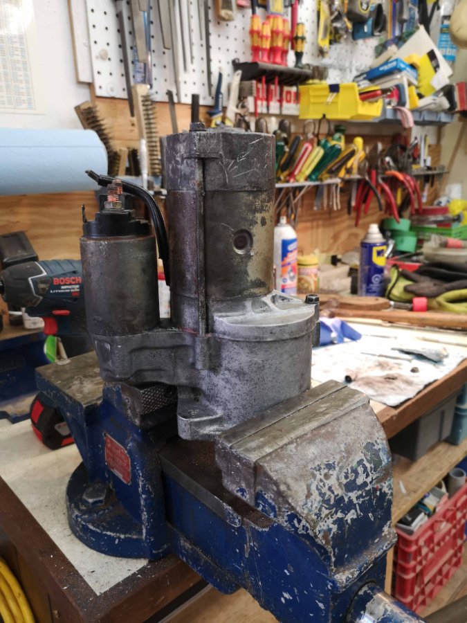

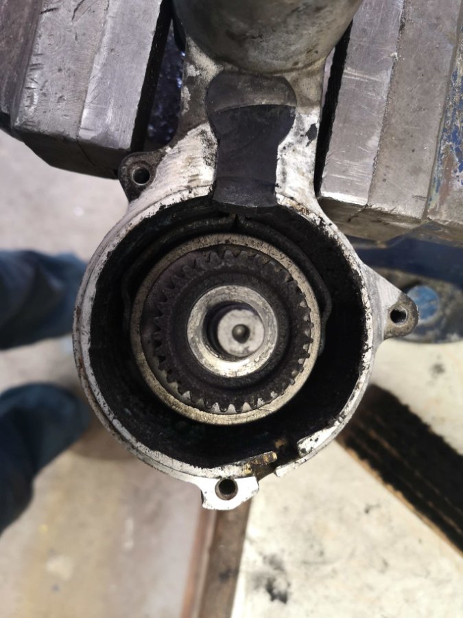

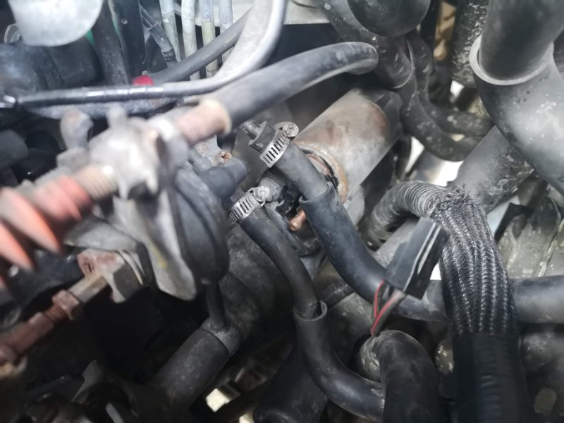

Been having starting problems lately. Part of it was the broken wireing, but she still starts slow when she's warm. So I decided to spend Sunday cleaning and to do a refurbishment on the starter motor.
It came out and went back in really easily! Hopefully this fixes my problem, but I bet I'll have to get it professionally rebuilt in October.
