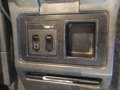

Hmmm....I do have another switch! 🤔
I just figured that the position of the shifter lever tells me when it's in 4WD. (Whereas reverse needs a switch to turn on the reverse lights). As long as the hub lock light works I'm happy.

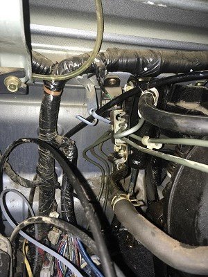

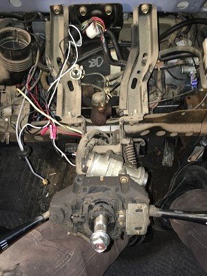

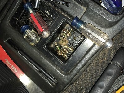

Over the weekend I replaced the brake and clutch cylinders. Worst part was getting the dashboard out but then it was smooth sailing.
No Dash.jpg (39.45 KiB) Viewed 25269 times
lots of screws.jpg (41.54 KiB) Viewed 25269 times
Hope they all go back to where they came from...
Brake Master Cylinder:
Brakes 1.jpg (61.38 KiB) Viewed 25269 times
Brakes 2.jpg (61.87 KiB) Viewed 25269 times
Brakes 3.jpg (46.16 KiB) Viewed 25269 times
Brakes 4.jpg (56.04 KiB) Viewed 25269 times
Clutch Master Cylinder:
Clutch Master.jpg (61.29 KiB) Viewed 25269 times

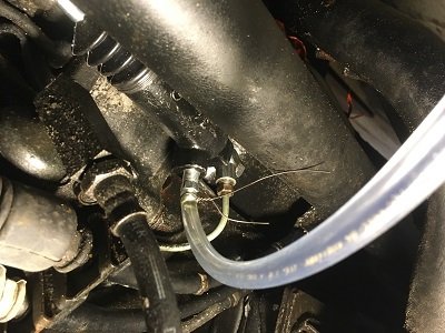

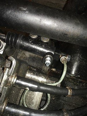

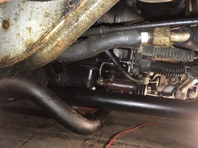

... and Clutch Slave Cylinder:
Slave 1.jpg (32.97 KiB) Viewed 25269 times
Slave 2.jpg (60.65 KiB) Viewed 25269 times
Bleeding the Clutch:
Slave bleed.jpg (34.51 KiB) Viewed 25269 times
And put it all back together...

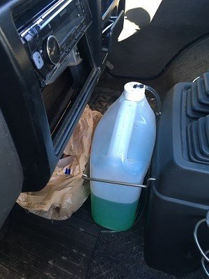

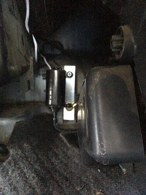

My windshield washer was pretty weak so for $20 I bought a replacement pump and mounted it under the dash below the center console. I've always found the Delica reservoir too small and a pita to refill so I ran a tube into a bottle of fluid and made a bracket to hold it. Refilling is now just swapping a full bottle for a the empty one. :-D Now the washer fluid sprays a good strong stream!
washer pump.jpg (52.6 KiB) Viewed 25269 times
Washer Jug.jpg (44.95 KiB) Viewed 25269 times
Someday I'll make a nice cover for it...

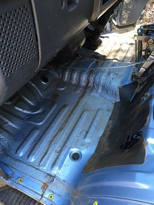

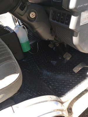

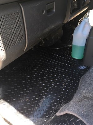

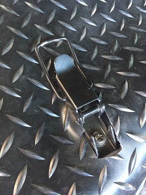

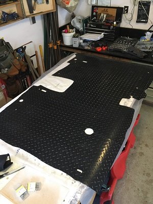

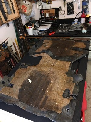

I ripped out the carpet and put in some rubber mat... $25 Princess Auto sale!!!
Happy to see the floor was still in good shape...
Used the old carpet as a template
Rough cut it oversize a bit
I shouldn't have cut out for the latches. I should have removed them and just screwed them on afterwards...
It looks pretty good...
A bit floppy on the driver's side but I'm hoping it will stretch out and relax into the contours after some use...
When it goes on sale again I may give it another go. I won't pre-cut all the fixing holes but feel them out in place. I missed on a couple :P
lrp374
Posts: 1023
Vehicle: 91 Super Exceed
Location: Kamloops
Post by lrp374 »
If that is the stuff on the roll? It works great but the smell just about made me sick. I finally took it back and they gave me my money back even though it had a few pieces cut out of it. Hopefully you won't have the same issue. :-(

Yup, it smells but I left it unrolled for a few weeks before I installed it. Hoping it doesn’t get gross in the summer heat....
