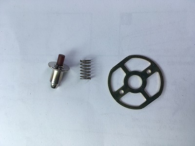

Excellent idea to bypass the power window relay! This has bugged me since I bought Wilson. After figuring it was too much of a contortion act to try to fit a jumper up under the dash, I pulled the relay, opened it up (just unbent the metal indents and it pulls apart) and pulled out the spring, post and that other bit (ie. all the parts that just fall out) and reassembled it without those bits; now it's always a closed circuit.

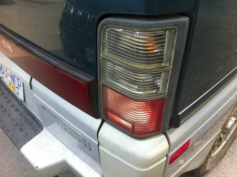

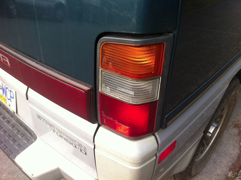

I swapped out the aftermarket, clear-lens tail lights that came with it and put in some stock lights, with regular amber turn signals.

Post by Morganizer »
I replaced the clear, aftermarket tail lights that came with the van with stock ones.

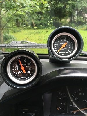

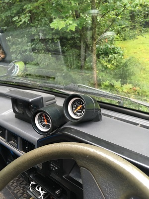

New Boost and EGT gauges arrived. Made some mounting thingies out of 2" ABS plumbing bits :-D
Gauges 2.jpg (61.67 KiB) Viewed 23621 times
Gauges 1.jpg (71.59 KiB) Viewed 23621 times

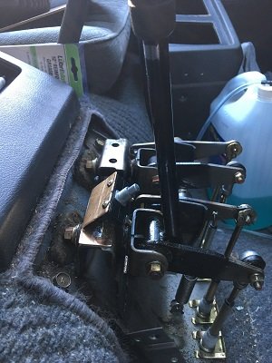

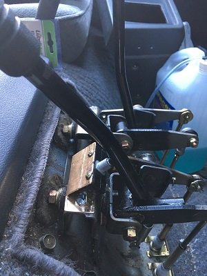

After crawling underneath to re-attach the reverse light wires to the switch on the transmission for the third time this winter, I decided to re-engineer the system and installed a switch activated by the gear shift instead. The old wires were corroded back about a foot from the old switch. Ran new ones up high under the body and around the engine compartment to the gear shift. All good now! :-D
Not in reverse
reverse switch1.jpg (32.29 KiB) Viewed 21847 times
In reverse
reverse switch2.jpg (31.06 KiB) Viewed 21847 times
