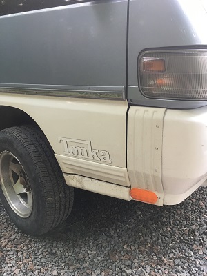

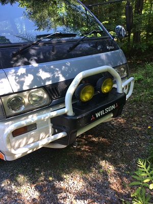

A couple weeks ago I got the front cowling and fog lights reinstalled...
I removed the "Mitsubishi" and insterted "Wilson" because, you know, I can...
and ...
because my neighbour said, "you should put "Tonka" on that...so...i did! :-D

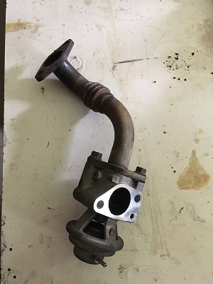

So, um,...anybody need one of these?

Shame, really. Such a pretty bit of engineering...

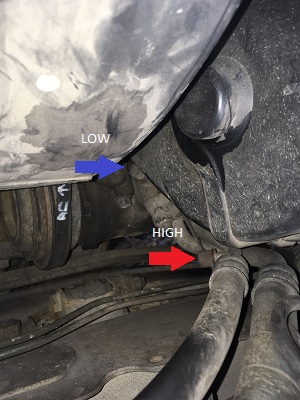

Yesterday I refilled the AC. I got the Princess Auto kit, put in oil, dryer, and system seal (I know someone recommended not putting it in but...)
Added the coolant and... COLD AIR!!! :-D
Took a while to find the ports, especially the low port, which is not on the pipe but actually seems to be on the compressor (91 L300)
AC ports.jpg (58.38 KiB) Viewed 19699 times

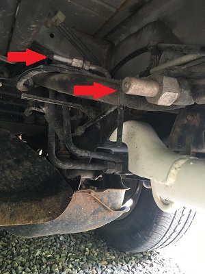

Also found these under the front...are they for the rear AC to tie into if you have rear AC?
mystery ports.jpg (56.05 KiB) Viewed 19699 times
33C today (Happy Canada Day!) and the AC still working...
Those ones are for the front cool box/ice maker. :-)

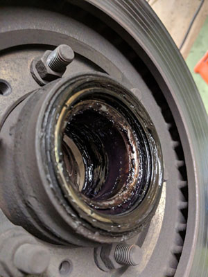

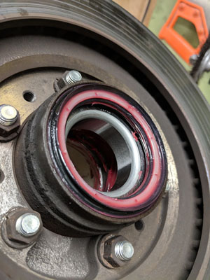

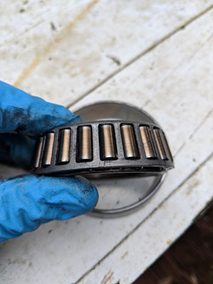

Replaced the front wheel bearings. Again. That "Premium quality high temperature wheel bearing grease" that was surprisingly cheap? Yeah, it didn't do a great job. Overheating bearings. Ugh.
IMG_20180714_153738 copy.JPG (44.56 KiB) Viewed 19606 times
So now we have lovely Redline CV-2 synthetic grease and genuine oil seals (the non-genuine ones I had before had very stiff flaps, and seemed to be worn away)
Though I'd forgotten just how much grease there is in the front hubs. Wheel bearings, locking hubs, driveshaft needle rollers... that's a lot of cleaning and reassembly.

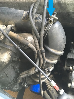

Well, that looks down right pretty!
Today I tracked down a vacuum leak...actually I think a boost leak. The hose had split just at the clamp so I cut it off at the split and put it back on.
Vacuum leak.JPG (60.38 KiB) Viewed 19589 times
I'll order a new hose but in the meantime this should do...I hope.
Power is back!
[edit: any idea of the part number for this hose?
and again: vacuum leak, nothing to do with boost]
