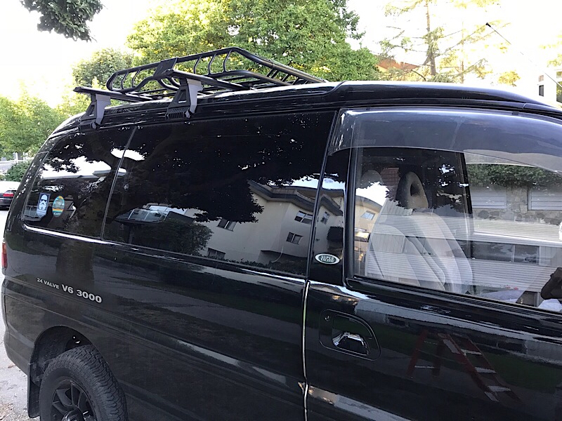

Finally got my roof rack and basket for my solar panel on the ol’ L400 Royal Exceed

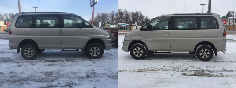

2" lift kit installed today! Alignment is next. Rancho RS9000 series shocks on the way for all four corners.
delica lifted (3).jpg (182.19 KiB) Viewed 18703 times

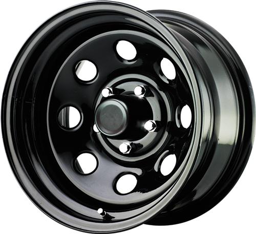

I'm looking at these rims:
Pro Comp Rock Crawler Series 97, 15x8 Wheel with 6 on 5.5 Bolt Pattern - Black 97-5884
with Duratrac's 31x10.5x15
and these fender flares:
Pacer Performance 52-192 Flexy Flares Black 1-3/4" x 58" Heavy Duty Reinforced Rubber Fender Extension Kit - 4 Piece
https://www.amazon.ca/gp/product/B00029 ... YIK6Y9EEQB
Any advice is greatly appreciated!

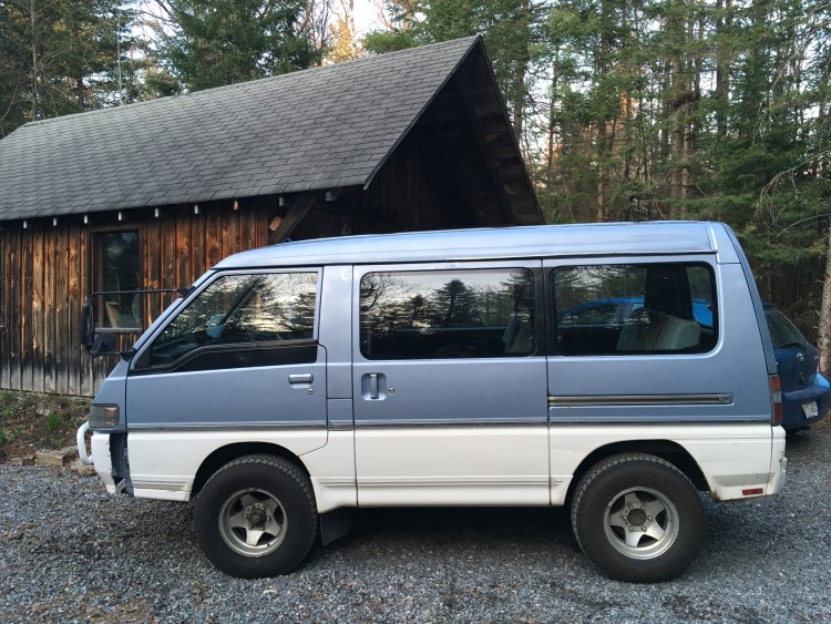

by deskinthewoods
Wilson at home.jpg (160.71 KiB) Viewed 17966 times
Well, I bought this one (named him "Wilson") last week in Edmonton and drove it home to Wakefield, Qc, just north of Ottawa.

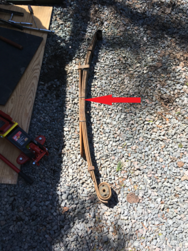

Tried to get it safetied on Monday but figured it wouldn't pass as Quebec safeties are notoriously tough, and it didn't. So over the last few days I have pulled off a rear leaf spring to have one broken leak replaced and reinstalled it
broken spring.png (407.32 KiB) Viewed 17966 times

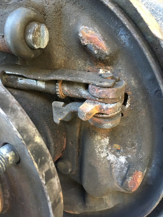

, adjusted the rear brakes where the left side adjuster was seized but I took it apart and got it adjusting again
Brake Adjuster siezed.png (711.72 KiB) Viewed 17966 times

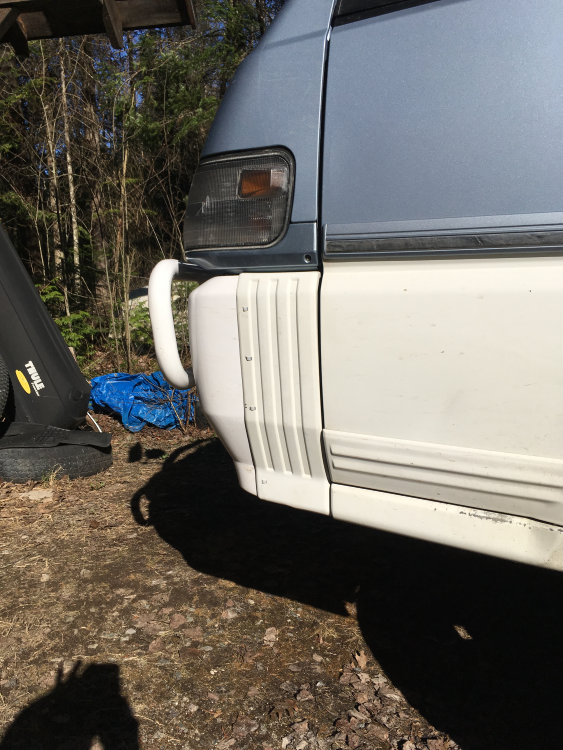

, installed a new muffler, installed a rear top middle brake light, installed rear mud flaps, added reflectors front and rear sides,
Mud flaps and tail light.png (797.26 KiB) Viewed 17966 times

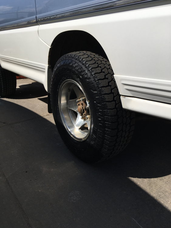

and, tomorrow I will adjust the front left bearing...oh, and there is a sticker on the driver's door that says the tire size is 215 SR15 so I had to do a quick KIJIJI purchase of used tires ($40) as the 235/75R15 I JUST PURCHASED are "TOO big for the vehicle, monsieu".
Big Wheels.png (560.93 KiB) Viewed 17966 times
Getting them swapped on Wednesday. Then, off to get it re-safetied and registered and plated. Then get the tires swapped back!!!
Posted: Sun May 13, 2018 6:25 pm
by thelazygreenfox
Any advice is greatly appreciated![/quote]
Hi Manitoba
The flexy flares work okay, may wrinkle a tiny bit in the flat top front fender wheels on the series 2 Deli. Not too many other solutions and certainly the price is good.
Try maching out a set of toyota mags. The centers need maching out but a much better idea than black steel rims. The offset is greater as well. I found a set cheap on craigslist. Talk to your tire shop about the rims, mine told me which ones to buy.
have fun

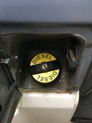

I was at the pumps the other morning, no coffee in yet, had the gasoline pump nozzle in my hand...."WTF!!!"...took some affirmative action...
fuel cap.png (159.51 KiB) Viewed 17771 times

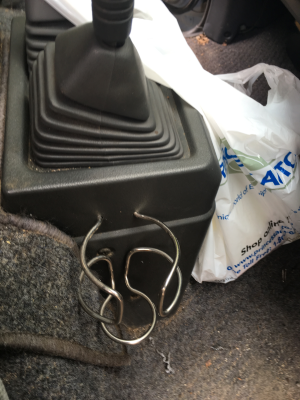

Also, so I can not be in a zero caffeine state at the pumps again, cup holders!
cup holder.png (189.37 KiB) Viewed 17771 times

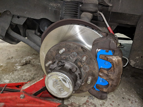

"I think the left front wheel locks up first" quickly got out of hand. Stripping and rebuilding the callipers, fitting thicker discs (from a Pajero or Pajero Sport), and a set of thoroughly mental Pagid RS5 brake pads because the race brake guy loves Delicas too.
IMG_20180621_193726 copy.JPG (81.96 KiB) Viewed 17658 times
And tomorrow, I get to bed the pads in! From the Pagid break-in procedure: "10 stops with low pressure from 150kph down to approximately 80kph, followed by a sequence of 5 stops with medium to high pressure from 180kph to approximately 60kph..."
I'm not sure the van will survive being pushed off a cliff 15 times, but we'll see.

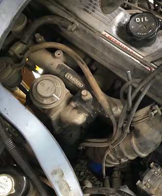

EGR rain.jpg (81.94 KiB) Viewed 17597 times

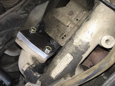

I performed the EGR removal operation.
Now you see it...
EGR 1.jpg (85.27 KiB) Viewed 17597 times
now you don't...
EGR 4.jpg (72.3 KiB) Viewed 17597 times

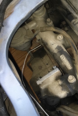

I used some 3/8" steel I had on hand (overkill) for the blanking plates and installed an EGT probe while I was in there.
EGR 2.jpg (64.85 KiB) Viewed 17597 times
EGR 3.jpg (59.05 KiB) Viewed 17597 times
Hoping to get the EGT gauge installed later this weekend, maybe a Turbo Boost gauge, too...
