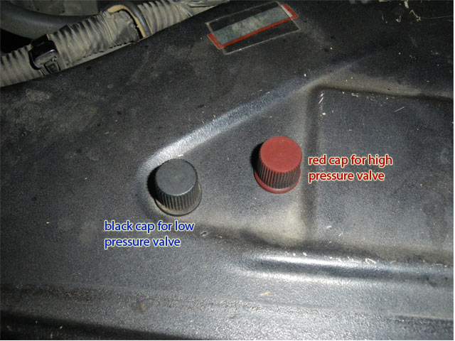

I have a question for those that have actually done this. Did you all have a low pressure port like was shown in afteroil's post? Or did you have the setup like mine. Two hoses one small (I think this is the high pressure) and one larger (low pressure...I think), both having a schrader type valve that accepts the adpater from the RedTek kit (see previous post on page 4 for pictures).

Thanks Andy! Is my assumption of the small one is high pressure and the larger one is low pressure correct?

Yes thats normally the case. Use the sight glass when filling it. Its under a rubber plug under the passenger side floor mat. WhenDelicaMark wrote:Thanks Andy! Is my assumption of the small one is high pressure and the larger one is low pressure correct?
-Mark
P.S. - Yes '91
the bubbles stop its full. Suerte.
Andy
PS The caps on mine were not marked like After Oil's were.

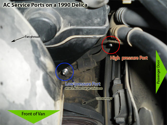

Three questions:
1) I visited http://www.REDTEK.com to watch the Installation Video and one thing they mention is to completely empty the old coolant from the system (by someone qualified) before recharging. Has anyone done this and how?
2)The video mentions the need to know how much refrigerant your vehicles AC system requires. Does anyone know how much the Delica requires?
3)Where the heck are the "Low pressure service port" and the "High pressure service port"? I have a 1990 Deli and I see one service port on the top side of the compressor, in the same position as "after oil" shows in his pictures on page 3 of this thread. However, I'm not sure if this is the high or low port. I think someone mentioned a port somewhere else but I can't find.

Ok, I think I answered my own question #3 above about where ports are. I went back and looked closer at "after oils" comments about it and sure enough, they were where he said. Here's a couple of photos that may help...

#3 Nice picture on the service ports, very descriptive. Good luck.

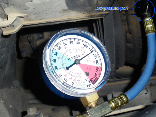

Using the good advise so far from people like Andy (modsquad), I'm getting through the trouble shooting of my AC. I have NOT yet recharged the AC with the RedTek. I figured best to do some troubleshooting to figure the problem first - which proved a good decision, now need a bit more help on what I discovered...
I found a blown inline 15amp fuse behind the glove-box, in my case the far right one of the three (see here for andys pics). Thank you. Now both cooling fans are blowing (one in front of engine fan & one under to passenger foot well). However, no improvement in the AC.
I connected the pressure gauge to the low pressure port and this is what I see for pressure (see pic below) - seems high. Any thoughts on what why? At least I know that the system is holding pressure (at 115psi). I think someone said in this thread that over pressure may cause issues?
so, fans turning, lines have no leaks, have high pressure - what next in the troubleshooting?

Now the picture of existing pressure in system - too high?...
