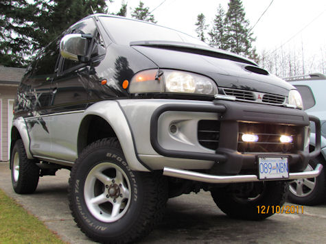

Finally got my bumper finished up and put back on........... 3months later, just could not resist that bedliner s#%t!
Also put in new injectors and re-wired glow plugs (tossed bar and ran 4 seperate 10 gauge wires to each plug, good recommendation from Jfarsang). Had cold starting issue like many others, not sure if it was the new injectors or the plug wires that cleaned it up, no problems now!
Sadly also put it up for sale as well, much fun has been had, but likely posted to Quebec 2012, no time to finish it up after work, house and kids :(
Good times for someone else to finish up though! (just some minors really: oil leak (as per mess in photo, valve cover I think), cv inner boots (have, but no time to install), remainder of sweet stereo needs to be installed.
Have listed on Craigslist (victoria) and Delica Trader, would post sale in forums, but have to wait for the usual bickering to clear up (probably be able to post in forum early next year I would suspect, hehehe) Will miss the bickering actually.
