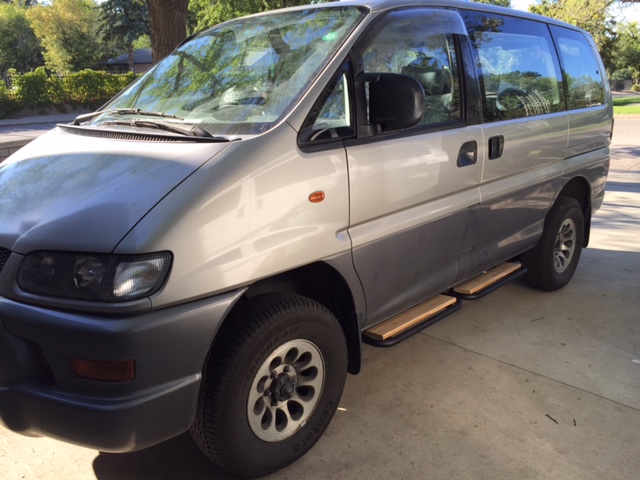

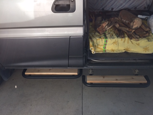

Took the footsteps off and cleaned them up then put a couple coats of spray on truck bedliner rock gaurd, then decided to switch up the plastic steps with some extra cedar wood I had laying around. Going to coat it with weather celant if I decide to keep the wood on. I think i dig it.
