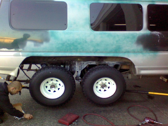

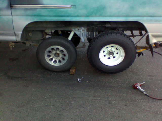

Well here's a little rear tire contrast for you,

Re: L300 Stretch updates
Post by fexlboi »
Wow, these are 33"? They look quite tiny on your huge lift. :-)

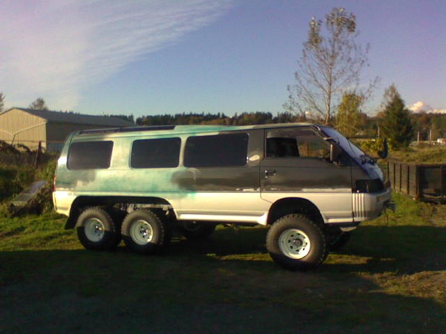

Yippeee, I got to drive her today.

You, sir, have managed to navigate the fine line between insanity and genius. I admire your gumption. Kudos!
Very cool. Come by the shop sometime for beer and tinkering. :-D
Richard Dagenais
Looks like it belongs exploring the moon ! 8-)
Very unique and hat's off to your fab'ing.
Does the front wheels articulate ? From the picture it looks like the wheel wells are tiny compared to the tires.
The tires actually have a lot of room to move, having said that the plastic farings will be coming off as I will the tires will be rubbing when I get to the mud..

Do the rear wheels both have drive?
Also, are you going to upgrade the engine? I've seen several New Zealand and Australia L300's retrofitted with bigger Toyota engines.
Finally, get that thing on the road and pull into the first scale you find. Very curious about axle weight.

RichD wrote:Do the rear wheels both have drive?
I will drive all six wheels eventually. That will happen at the same time I put a bigger engine in. But I need to recover from the initial costs of the body join.
