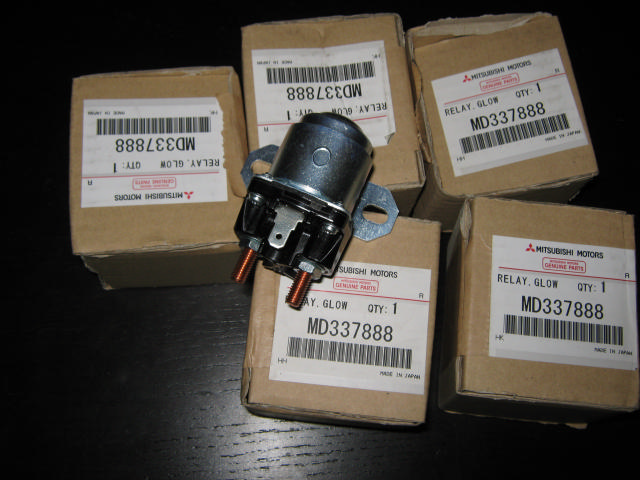

I returned from USA last night, so I didn’t see this video until this morning.psilosin wrote:Interesting. The new relay I just installed on Tuesday is toast.
Trigger wire from ECU (SRG) is operating fine supplying voltage for ~6 seconds. Power supply to the relay is fine. 0 power at the switched terminal when activated. Not yet bench tested but it looks dead by all account.
Jcolvin, I am interested if you had a chance to re-test your new relay to see if it cooked as well. I'm going to pick up another today and reinstall to see if this is just bad luck or if shinanagans are afoot.
For fun here is another startup video. This time trying to start the L400 at -4oC. I got tired of eating smoke sandwich so I gave up before she fired (sensitive viewer alert: f-bomb dropped).
Yes, glow plug relay was completely gone.
It will be very simple to fix, just replace it with new/used oem.
I said several times not going cheap aftermarket relay as they turn out hassle and more money in the long run. Not worth to argue about this.
We have lots of OEM glow plug relay in stock FYI.
Steven

All OEM parts are being sold by Mitsubishi only.nxski wrote:The extent of my moderating right now will be to say please be nice to each other, focus on the op, and no advertising.(I can't do much else from my phone). As for doing my job, that is what I'm doing right now and do 7 days a week.
Part numbers with pics tell everything with easy way.
Steven
Re: Problems starting in the morning or when cold ? Adjustme
I agree, there is nothing wrong with part numbers and pictures.
