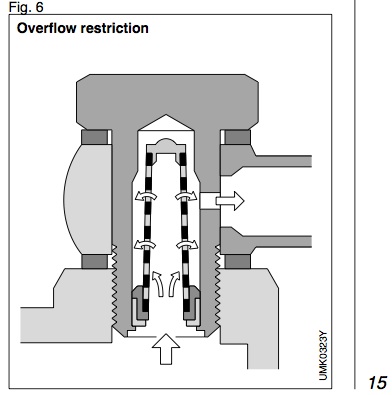

Good thing not to remove it. I found this Bosch training manual that described the function:
Overflow restriction
The overflow restriction (Figure 6) is screwed into the injection pump’s governor cover and connected to the pump’s interior. It permits a variable amount of fuel to return to the fuel tank through a narrow passage. For this fuel, the restriction represents a flow resistance that assists in maintaining the pressure inside the injection pump. Being as inside the pump a precisely defined pressure is required as a function of pump speed, the overflow restriction and the flow-control valve are pre- cisely matched to each other.
Ralph in Winnipeg wrote: But apparently stuff gets to there
I found silicone caulking around my fuel inlet (OMG no!) and am having some trouble somewhat like yours. I wonder did you have leaks included in your symptom's, Ralfph in Winnipeg? Perhaps fuel pushes past my drive seal because so much fuel gets pushed back to the supply side by the pressure control valve (due to an overly restricted overflow).
