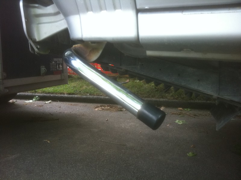

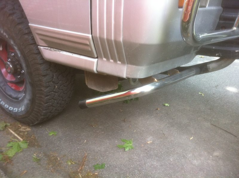

A simple modification for the side steps and...presto, radiator guards!
- IMG_1039.jpg (76.51 KiB) Viewed 6438 times
- IMG_1040.jpg (75.73 KiB) Viewed 6438 times
- IMG_1041.jpg (77.29 KiB) Viewed 6438 times

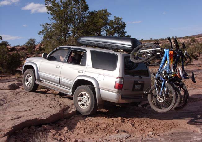

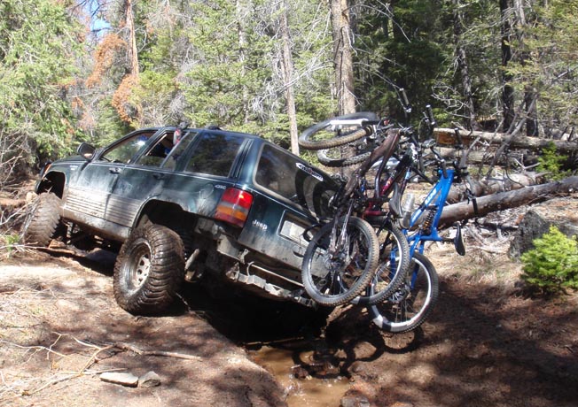

Also, back to the comment about the bike rack...I found these pictures of the rack in 4X4 mode
- bike rack.jpg (133.54 KiB) Viewed 6428 times
- bike rack 2.jpg (81.68 KiB) Viewed 6428 times

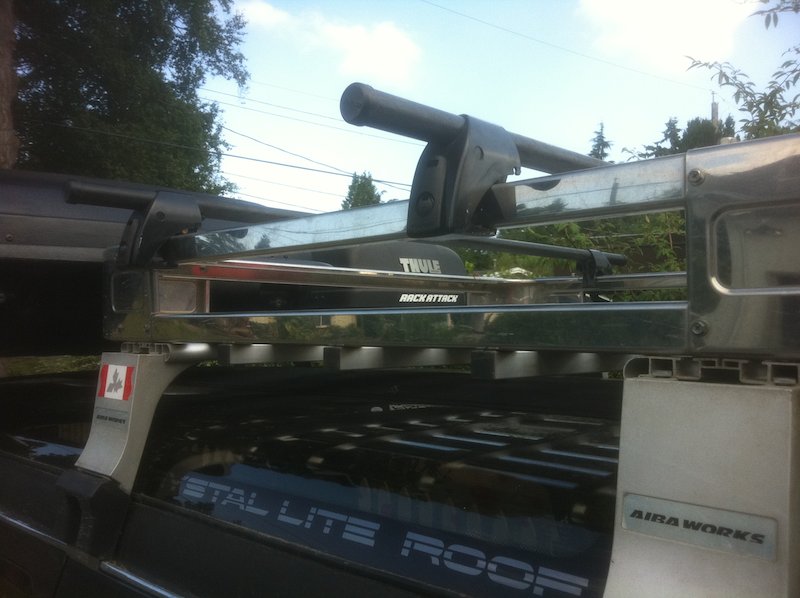

Here are some pictures of my latest unintentional mod. I was given a set of Yakima racks for a 2004 Ford Taurus Freestyle (that's what I'm told) but one of the sides was missing the rubber 'paint protector' so i didn't feel good about selling them. It turns out they fit very well on my Aira Works rack and provide a nice divider for my Jerry cans.
- IMG_1232.jpg (74.5 KiB) Viewed 6413 times
- IMG_1233.jpg (74.04 KiB) Viewed 6413 times
- IMG_1234.jpg (73.92 KiB) Viewed 6413 times
