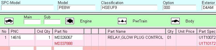

If you need to cross reference the part number here is what I got from ASA.
