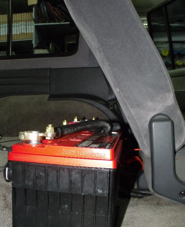

Project part 1.

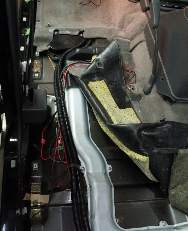

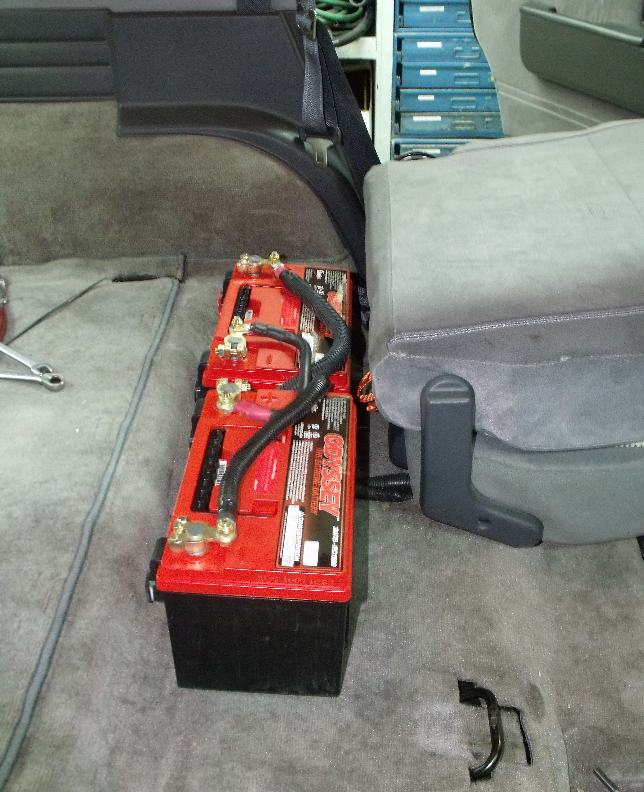

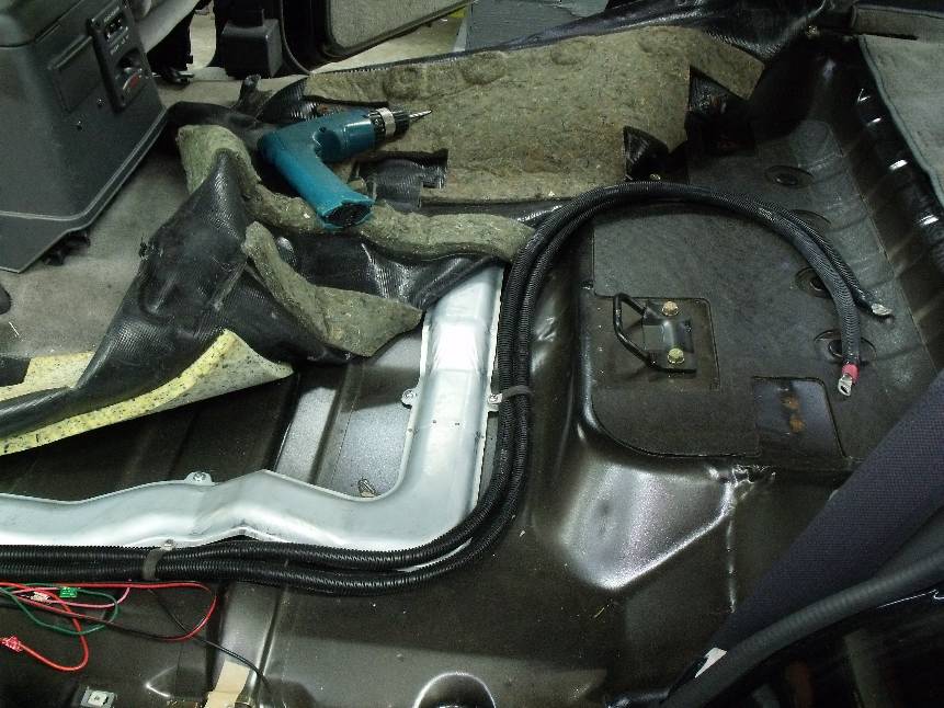

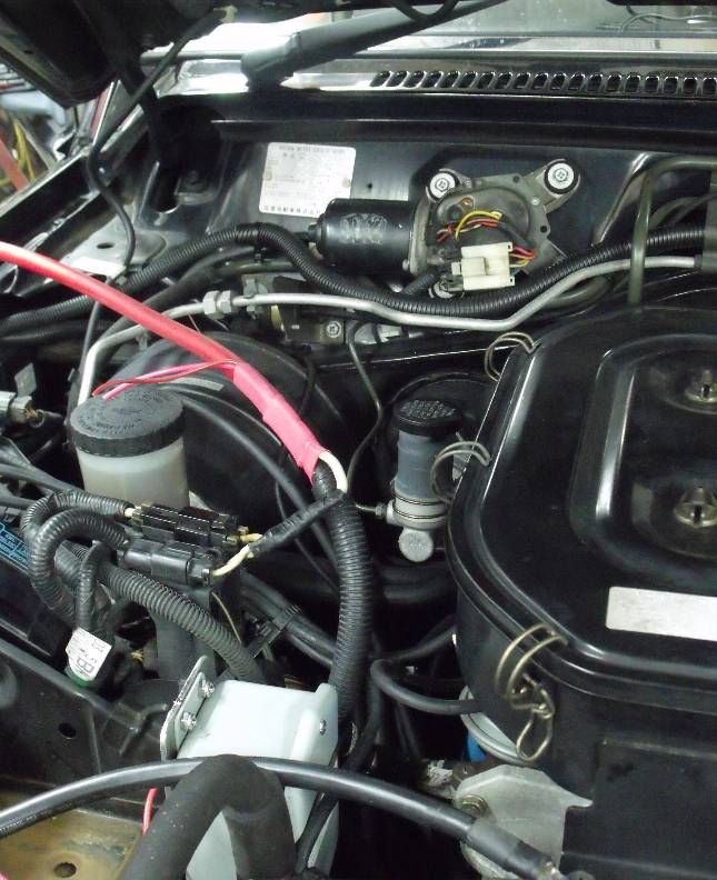

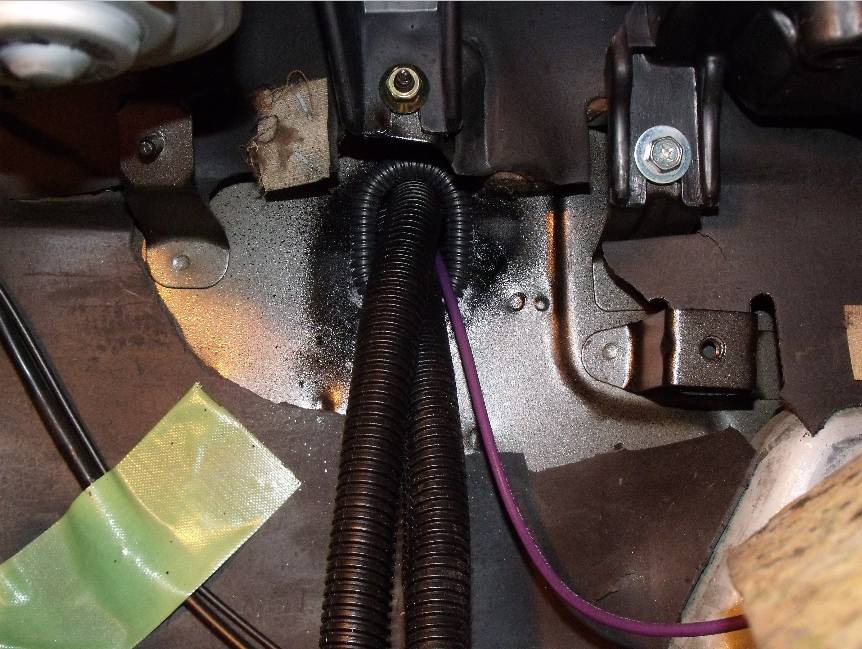

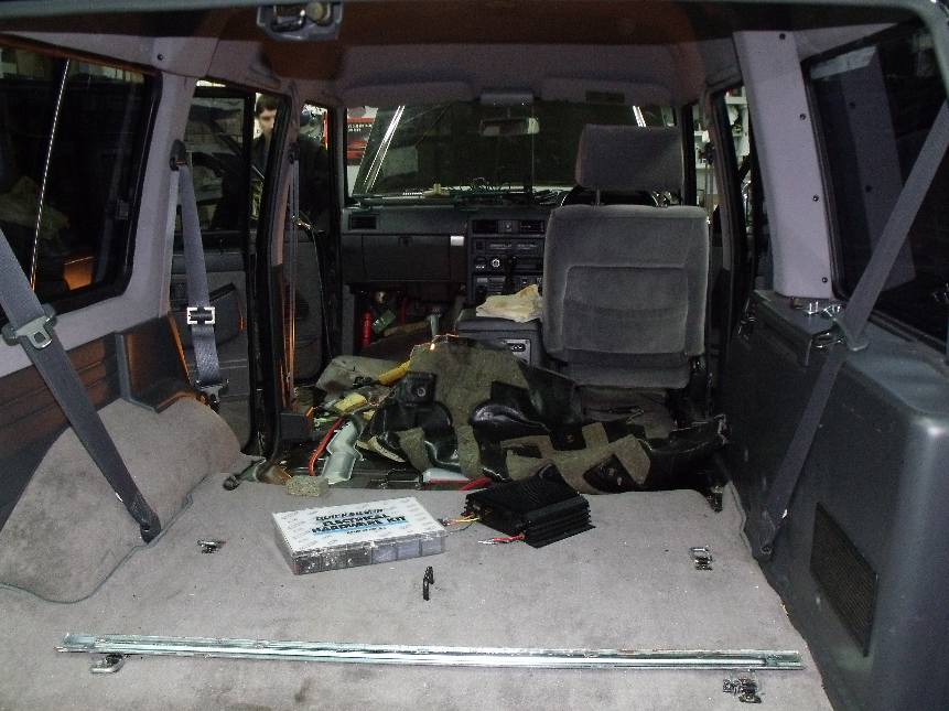

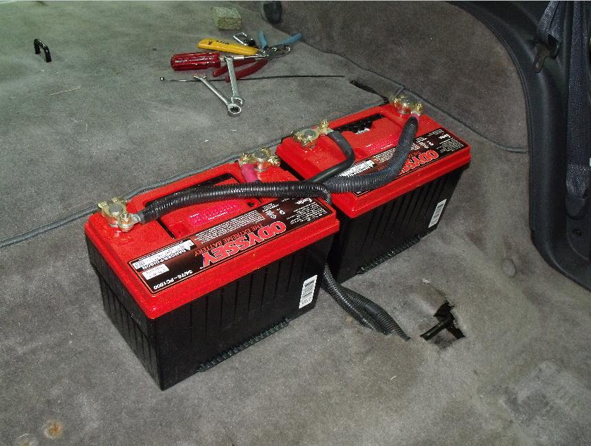

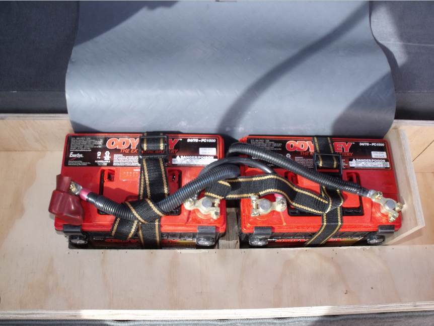

I decided to relocate the 2 batteries on my 24v Safari and move them inside the cab, just behind the rear passenger's seats.
I'm installing a by-pass remote oil filter, a wvo veggie kit and soon a snorkel so engine bay real estate was at a premium and those 2 batteries were the logical choice to free some much needed room.
I bought two Odyssey 34-PC1500 that punch out a nice 880cca each and also act as decent deep cycle unit (AGM so safe to run inside the truck). I also needed about 10m of No. 1 battery cable and crimps.
I looked into running the battery under the chassis but decided to run the cable under the carpet to minimize drilling holes in the floor and also save on cable length.
The cable enter the cab at the feet of the front passenger through the firewall then follow the original rear AC ducting.
Part 2 of the project will be building a custom box to secure the batteries, I'm thinking of building it of 1/2" plywood, strong and light. The box should also have extra room for gears.
We had a go at it last night with my good friend Jay who I happily refer to as my Electrical Guru. Pictures will describe it better than I can do so here we go...

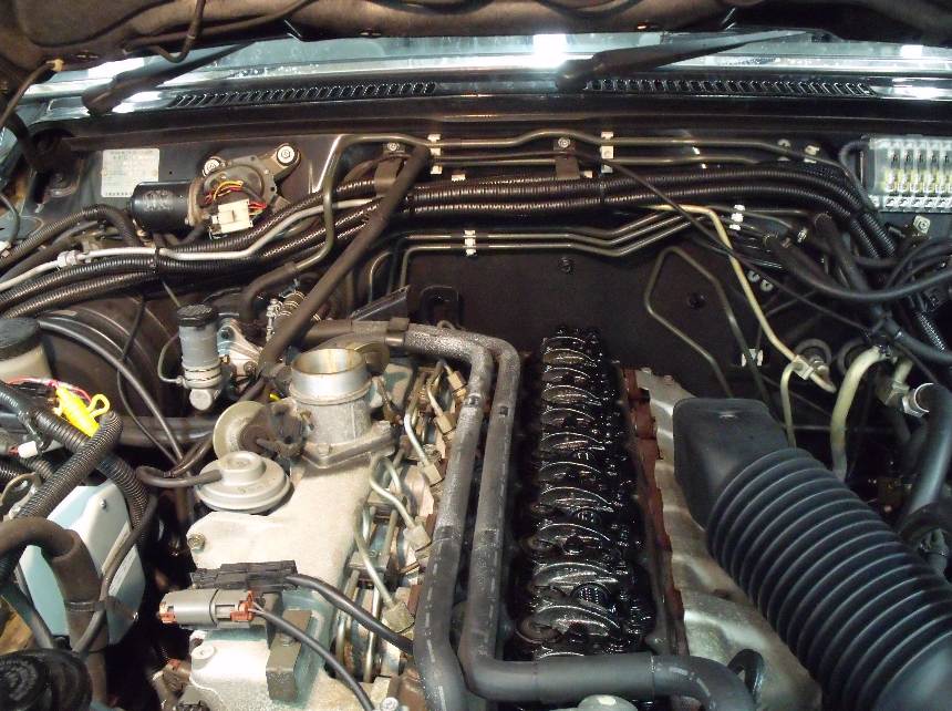

Ctn'd...

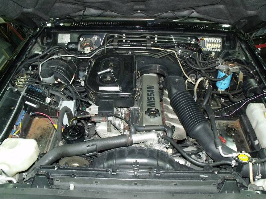

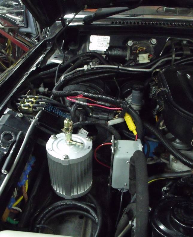

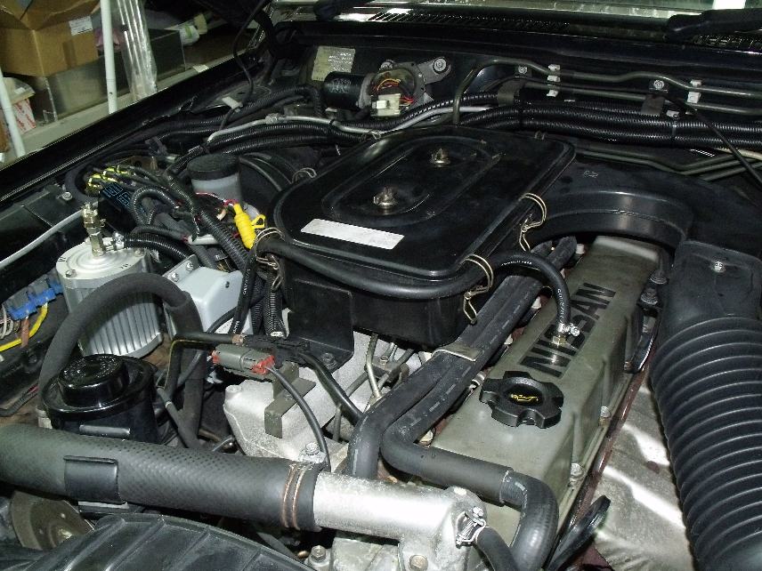

One on of the picture you can see my new oil by-pass filter mounted where the battery used to be...

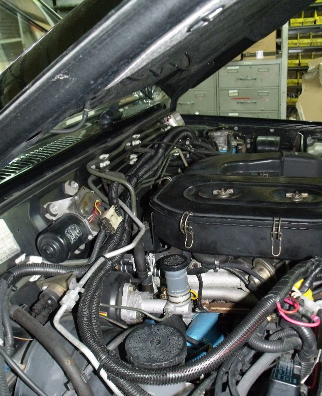

You weren't joking when you said the engine bay was FULL! I'm also going to go out on a limb and speculate that you're going to do something a little more discreet with the batteries behind the seat...

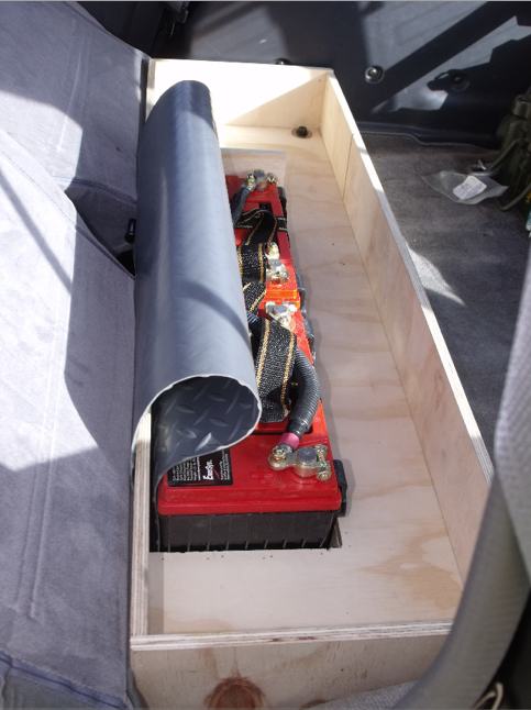

I would add a battery disconnect switch at the batteries just in case!!
I have had a 12volt 1 gauge wire short and I do not wish that on anyone.
I would put a rubber heater hose over the wires through the firewall as well for added protection (that plastic wrap can wear fast especially on rough roads). you can slit the heater hose and pass it through and tape it both sides.
Tie them down good you do not want two lead boxes with acid fly around in a roll over with you. I usually put 1/2 threaded rod with heavy angle steel on each battery through the floor with big washers (1.5 inch square) on both sides of the floor.
Looks good
Looks good

Yes Paul, Part 2 needs to be taken care of asap. I'll be building a 1/2" plywood box to secure both batteries and some extra storage space. This box with the batteries will be sandwiched between the rear seats and the future drawers/bed base that will be a summer project.
So once I'm done with the battery box they should become a sealed and safe unit. Should do it next week, dealing with kitchen passes now...
And for the firewall hole it's a good idea, I've done it for my snorkel and it worked really good. But I'm not too concern right now, there's 2 layers of split loom in there... should be fine until all the fun mods are done!

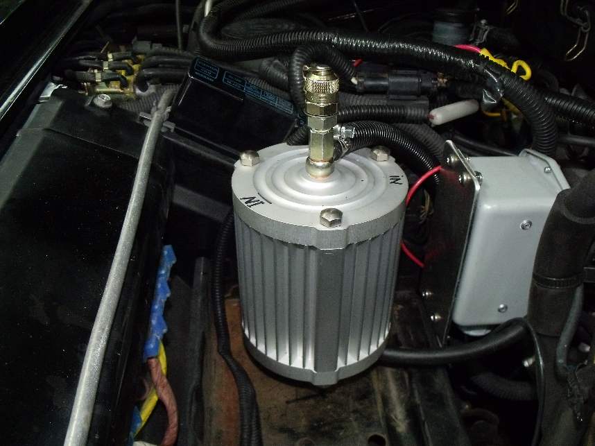

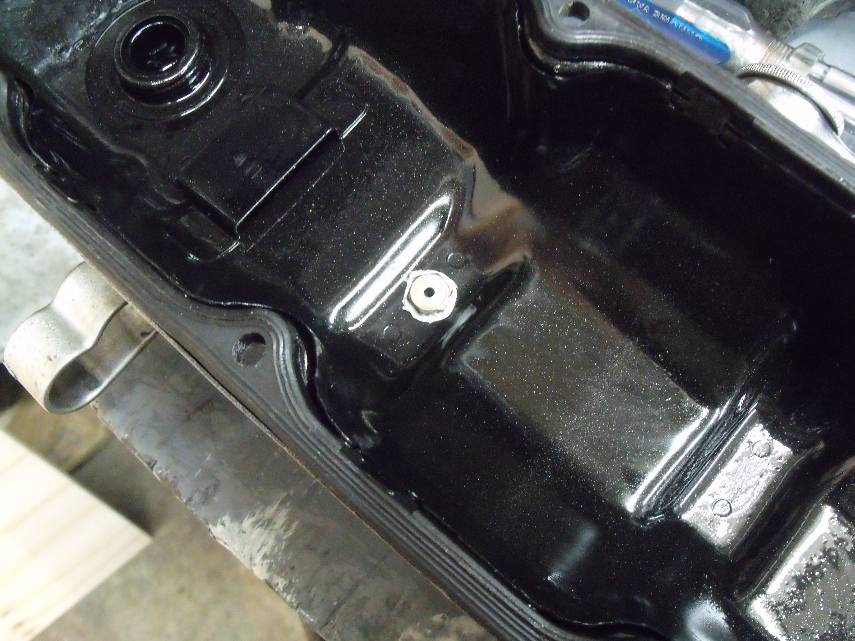

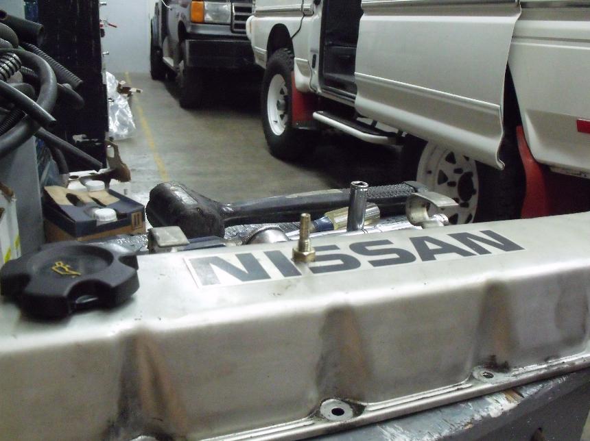

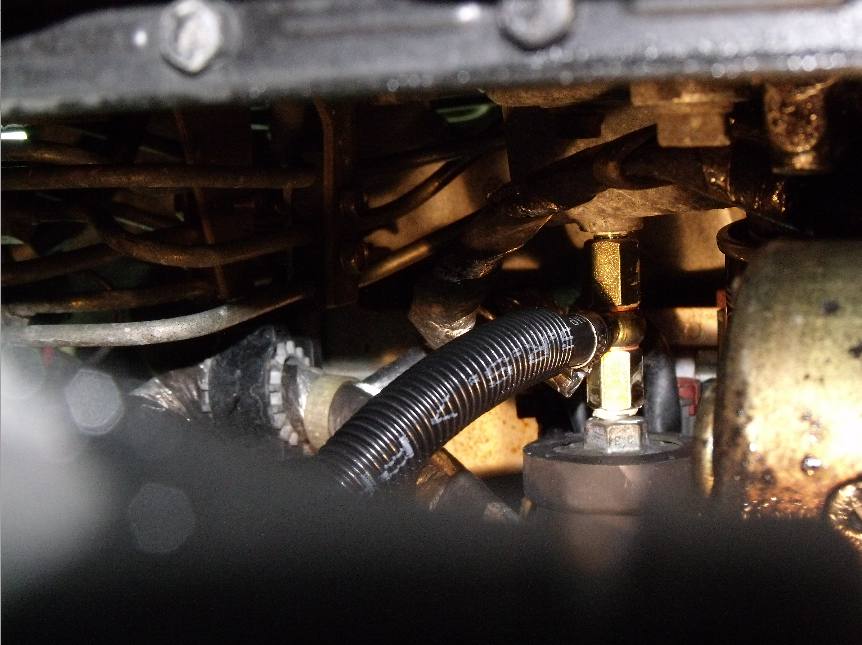

But not to be undone, here's one more mod that I just finished tonight; installing a TRABOLD remote (bypass) oil filter. It was a pretty easy install once I figured out where to mount it.
It's a German unit that's got pretty good reviews with Portal Expedition vehicles. I'd have to look at the specs again but I think it filters down to 0.1 micron and they suggest changing the filter cartridge every 24,000km, the OEM filters every couple years and the oil (synthetic) some crazy numbers (over 300,000km)! Regular oil analysis will tell me how far fetch or accurate those claims are... but it can't hurt to give it a try.
Here's a few pictures showing some of the prep work, install of the return line on the valve cover, the pick up line "T" at the oil pressure switch, the remote filter and the final result. Only thing I'd change if I'd do it again would be to move the return line on the valve cover further front and on the side instead of the top...
Nice thing with this unit is the filter element is accessed from the top and the option to have a oil sampler port (at the top) to make oil sample pick up made easy. With the fins on the unit it should also cool down the oil, maybe not where I mounted mine but move it by the grill and I'd see some benefits.

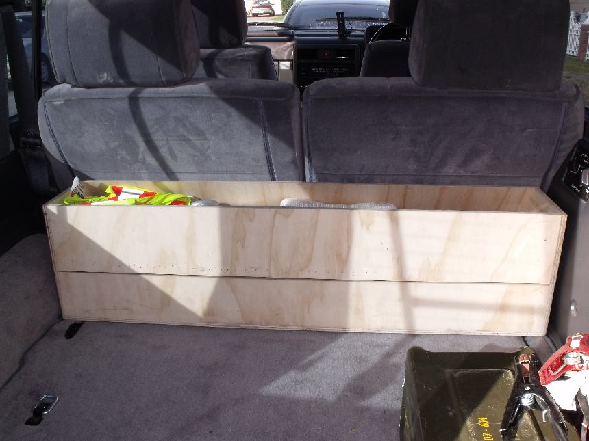

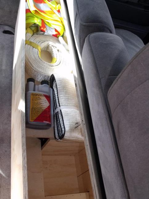

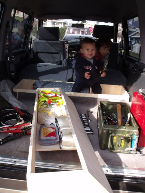

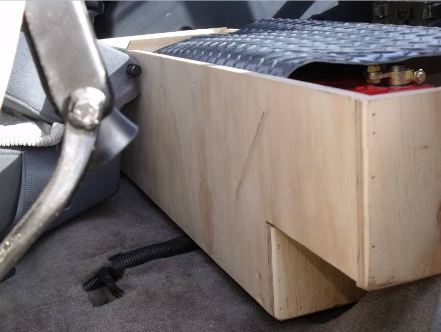

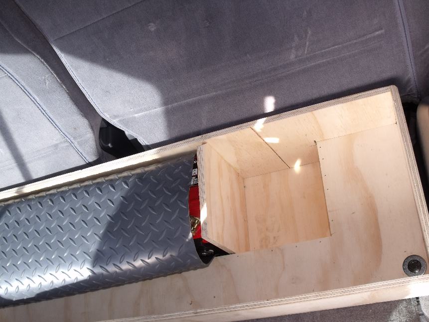

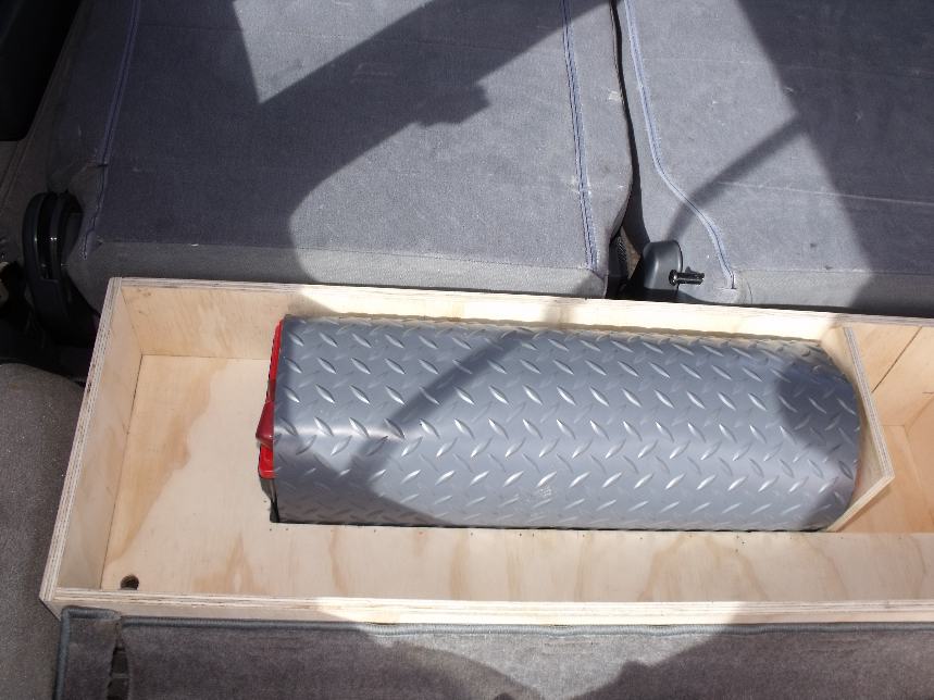

PART 2

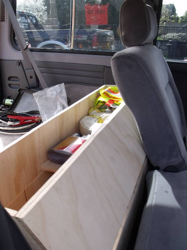

I finally find time to post some pictures of the storage box I made to secure my batteries. It's made of 1/2" plywood, glued and brad nailed together. Plenty strong and light. It's got 2 parts;
The bottom one is mainly for the batteries but overlaps side and rear for extra storage, long items... The batteries are covered with a heavy rubber mat.
The top one is for storage and it's floor doesn't extend all the way so that the remaining free space beside the batteries can be used through the upper unit for taller items. I'm not sure if I'll use a hinge to connect both boxes or leave it removable as it is.
Both boxes are secured together by a latch (not on pictures). The batteries are also secured to the box with marine grade battery straps.
The height of the boxes was set to line up with the folded middle seats so that I can make a bed once the rear storage box is built up.

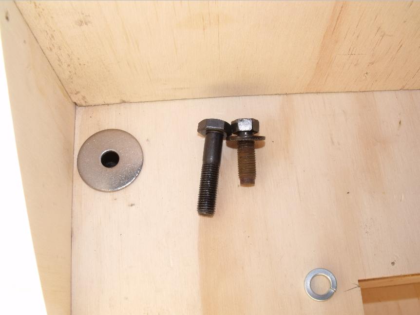

I've used the forward bolt from the 3rd seat attachment to secure the box to the truck. The rearward bolt will be used to secure the upcoming rear storage/drawers box. I also had to use longer bolts.
I still need to make the upper box's lid (ran out of wood) and gelcoat it, just need more free time, one day! I did get some help though... Hey Jay, a big thanks for letting me use you table saw!
David
