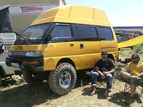

As for departure angle, yes the 400 would be better as the wheels are closer to the front but then with the 300 you have amazing viewing angle which the 400 can't beat. Also, a properly set up 300 can end up with pretty decent departure angle.
See what I mean... :-D
But as great as they are, they are still quite limited for serious offroading. But hey, you can bring all your friends along and their gears!
(I wonder if that yellow van can turn it's front wheels?)
Re: Old member, tough decisions - comparion between L300 & L400
Probably not but I love the hightop :-D
