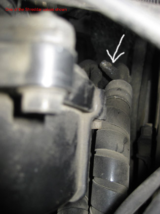

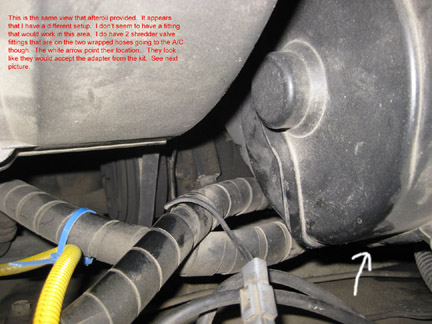

I took a closer look today at this and found a couple of things that confused me. I don't seem to have the same setup as afteroil does. See picture below. There does seem to be 2 obvious places to attach the adaptor from the kit. They are both on the wrapped hoses going to the A/C unit. One of the hoses goes to the main radiator and the other goes down and out the front left to I assume the A/C radiator (maybe the wrong term). So assuming that I am right and that I need to attach to one of these valves and that I have a different setup then afteroil does, which one is the low pressure and which one is th high pressure? I am trying to find the low pressure. Is it the one that goes to the A/C rad or is it the one that goes to the main rad? Or neither and I am totally out to lunch?
Here is one of the sheddar valves.

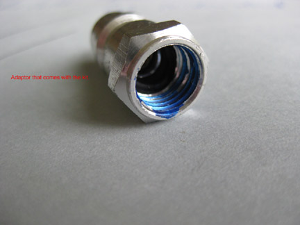

Here is the adaptor from the kit which looks like it will fit onto the above valve.

Did some quick checking on the world-wide-web :-) and found this:
LOCATE THE SERVICE FITTINGS
Next, you need to locate the service fittings on the A/C system. There are two: a LOW side fitting and a HIGH side fitting. The LOW side fitting is usually located on the suction hose or line that goes from the accumulator to the compressor. The HIGH side fitting is located on the line that goes from the compressor to the condenser.
R12 Low Side 7/16 in. threaded ß----------à R134 Low Side 13mm Quick-disconnect
R12 High Side 3/8 in. threaded ß----------à R134A High Side 16mm Quick-disconnect
On older R12 systems, the LOW and HIGH pressure service fittings are screw-type Schrader valves. On newer R134a systems, the LOW and HIGH side service fittings are quick-connect style fittings. The LOW pressure fitting is SMALLER than the HIGH pressure fitting.
So I am guessing that which ever valve it fits on is the right one as the low and high sides are different sizes.

sounds like youre on the right track... my low pressure port had a cover on it that said "L" i assume it means low...
why dont you use the search function you idiot!!??!! (thats a huge dark sarcastic joke, no offense meant! :? )
theres a great diagram here:
http://www.delica.ca/forum/a-c-head-scratcher-5807.html
you can map your system to find your ports...

I had looked at that schematic that was posted. I am not sure what the evaporator and condenser are in relation to our vans. I am guessing the condenser is what I called the A/C rad on the front left, which is where one hose goes and the evaporator is the main rad which is where the other hose goes.
I just tried the adaptor on each schedder valve and of course it fits on both...big surprise.
Wish mine had a big "L" on it for me too.
-Mark
