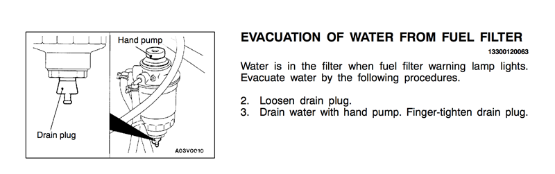

Lapprentis wrote:\I would consider emptying ALL your fuel from both tanks and fill it up again with "Fresh+Clean" diesel of a reliable source.
Good thought- contaminated fuel could account for this. Though, before draining the entire tank I'd drain your fuel filter into a jar and look for water contamination first.
Fuel filter water.PNG (78.63 KiB) Viewed 10214 times
To eliminate the fuel supply as a source of failure you could remove the fuel hoses from the filter and put them into a container of fresh, clean diesel (though you might need to fit longer hoses and re-bleed the injectors).

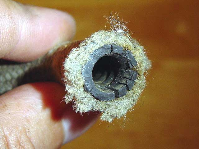

I had a bunch of air leaks in my 7.3 idi, and when I started to hunt them down I was told that air can get in even when diesel cannot get out. so even if your not leaking fuel from a hose, it doesn't mean it can't be sucking air in. I don't think that would cause you to go from running happily to dead in the water...but if you removed any of the original fuel lines as you've done this work you could've created air leaks along the way.
I hope that thought does not stress you further, just go over your fuel line clamps again (if you haven't yet) and double check that everything is tight and there's no badly cracked hose ends. The other thought would be air intrusion from the tank side. If you can double check the fuel tank where the sender and float attach.

Starting after sitting a while or after pumping the fuel filter primer pump, but dying soon after, sounds like an air leak. The usual place they fail is at the injector pump seals, with the front seal around the shaft being the most irritating to change (and therefore the first one to fail), but I can't imagine why yours would have suddenly failed.
When you managed the 10 seconds of running, did you try to keep the revs up? Sometimes a first start after fuel work needs 30 seconds or so running at 1500rpm to clear the last of the air out. But I don't think that's the issue, as it would start easier the next time.
I wonder if your new solenoid has some kind of weird air leak, or if the failure of the old one somehow blew a seal? Or maybe a rubber fuel line has been disturbed and started to let air in after all the work in that area. Check the ends of the rubber hoses, look for any cracks at the end.
It might be time to swap out your rubber fuel lines for transparent ones and see if there are any air bubbles. (Just the two rubber hoses that go from the filter to the injection pump, plus the small one that goes from the injector return line to the pump).
