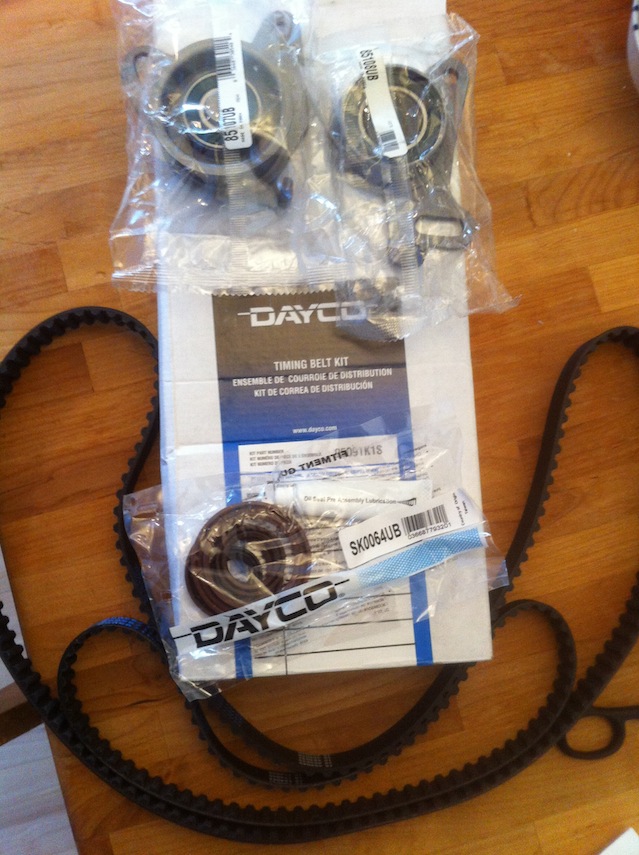

Well, I went with Italian. I bought a timing belt kit by Dayco.... for the north american 2.3l. Tensioners, belts, three seals under 100CAD suited my budget'think any of the parts will fit?
Perhaps I will be reusing old equipment when I put it back together. The most immediate concern still being the leaking IP front seal.

Each of the belts, tensioners, cam seal from the dayco kit were a fine replacent. The balance shafts and crank seals I did not use. Rock auto says there are more of these now, tho when I ordere it said one remaining.
Little tight drilling holes in the old camshaft seal to remove with rad in place but doable using short drill and bits.
Tensioners seemed every bit equal.
