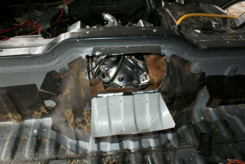

Wow, now that that ugly part of my life is behind me, I can get started again. Installed the distributor this morning. Had to cur out the back of the firewall to get it there.
First I made the bottom cut, installed the hinges, then made the next three cuts. She slipped right in!

Just so you know the distributor is on the front of a Ford small block
So get the wires on and fire that pig up!!

thedjjack wrote:Just so you know the distributor is on the front of a Ford small block![]()
Funny, you're not the first to say that!!
Just noticed the fuel pump has been compromised, but electrical should be done in the next few days..

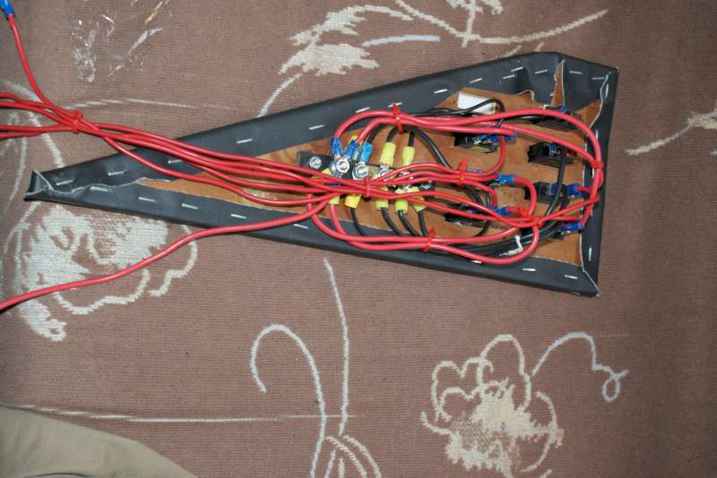

Aux switch panel now fully wired.

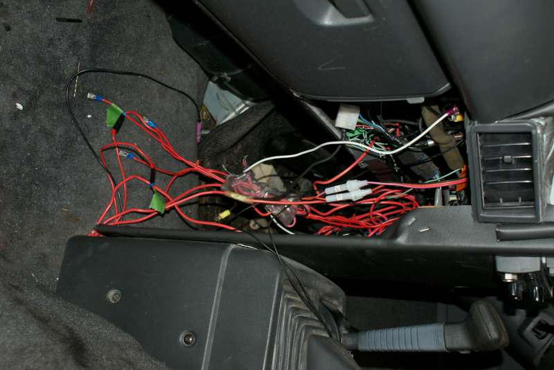

Spent all day doing a 2 hour job because i keep forgetting to think ahead and had to undo everything at least twice. I was smart enough to take photos of everything, however I was not smart enough to put the card in the camera. So all I have is a finished photo.
First pic is the back side of the center console. The second are the wires for the light bar, The come out just below the drip rail behind the pax door. There are three layers of metal there to drill through and try to feed wires through. I still need to put a ground wire through and then seal with silicone. Exhaust headers were dry fitted today as well.

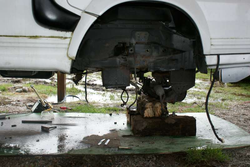

Well the front end is out.
SAS next week (hopefully, parts are on order)

Well It's all cut away. (I Takes a few blades to cut out welding that you put in with the intent for it to stay) And the dry fit for the SAS is happening tonight.

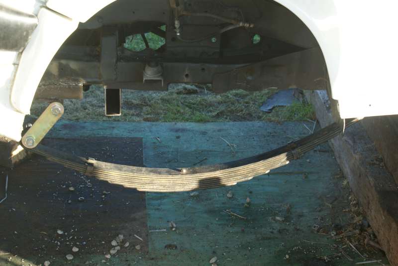

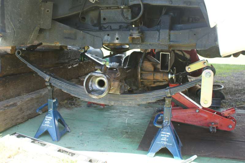

Bit the bullet and hired in some guns = Leaf springs hung!!!
Hopefully over the next week I'll get the axle installed and then we can reattach the steering. Custom rad is supposed to finally arrive this week.

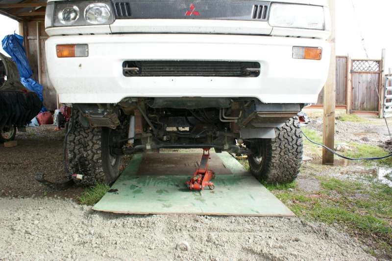

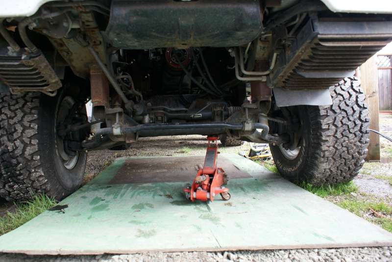

Re: L300 Stretch updates

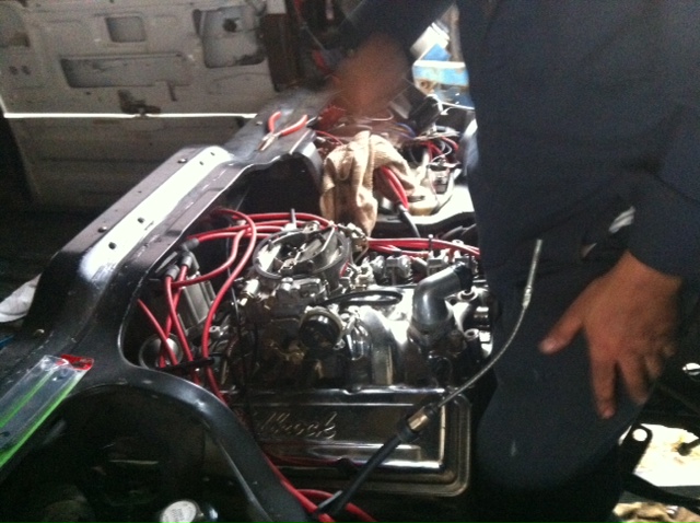

Front axle in and staying there, starter in, fuel pump in, timing done.
Getting closer
Getting closer

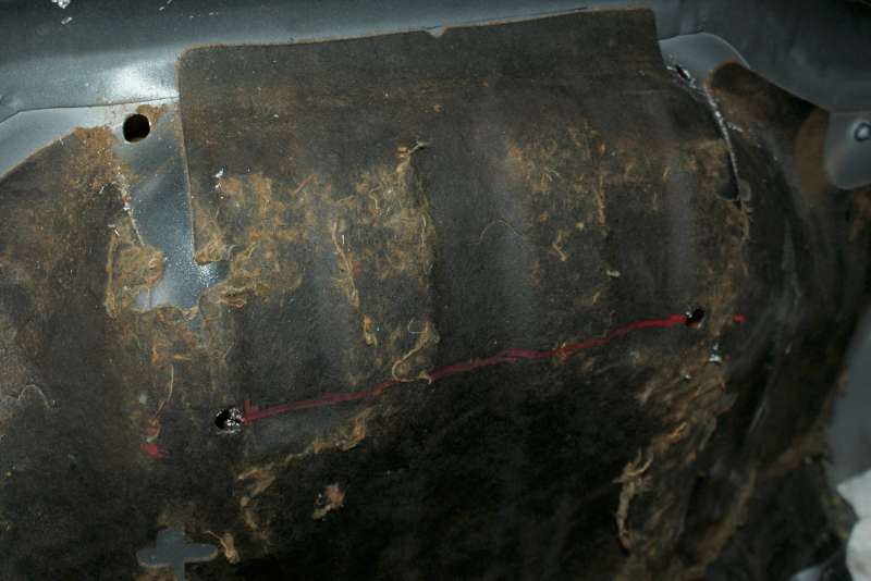

i hope you plan on using some kind of 'sound deadener product' inside the delica, otherwise you may develop hearing damage.
al
al
