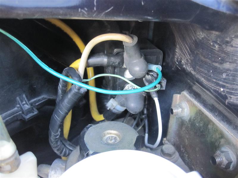

Glow Plug Relay died again meaning no starts below 2oC for me all week so enough was enough. Time to be done with that Mitsubishi pos and replace it with something better and cheaper. Unlike last year where due to relays size and shape I had to install in a goofy location, the new swank relay I purchased uses a single mounting tab meaning it fit real nice and sexy like in the oem location.

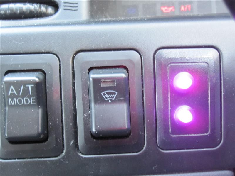

While I was in there I decided to add a simple twin LED status indicator with two Prince and the Revolution Purple LEDs. The first connected to the ECU that will ignite whenever the ECU is trying to activate the Glow Plugs, and the second connected to the output end of the relay that will ignite whenever the relay is activated successfully. If things are working as they should then both LEDs should be lit at the same time, if only the first then the relay has failed, if none then the ECU is flaky.
It was 1oC when I finished the job today and it started up instantly. WIN.

Do the Prince lights stay on all the time while you are driving, or do they shut off eventually?
Craig
psilosin
- Posts: 1045
- Vehicle: L400
- Location: BC
The Prince and the Revolution LEDs are only on when the glow plug system is active...so for a cold start they will be lit for 2-3 minutes and then be off for the rest of the drive.

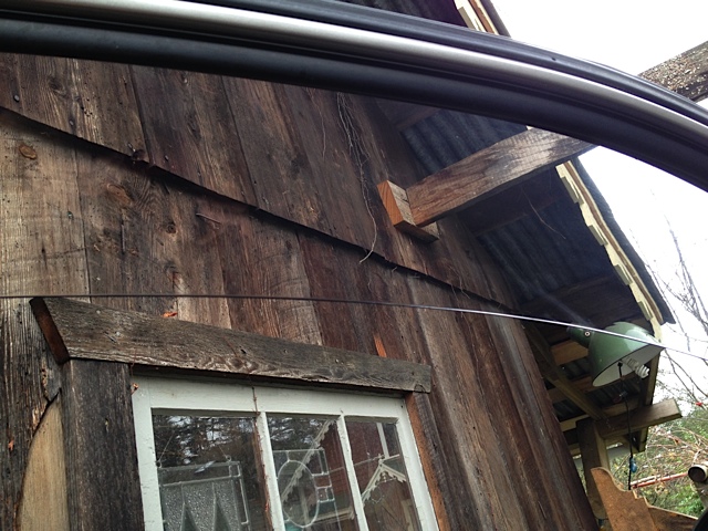

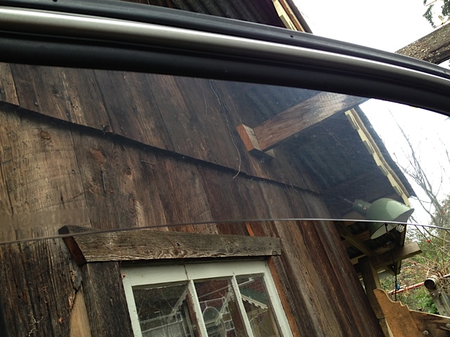

Polished my windscreens , my new van came with the larger style of windscreens , not crazy about them but a 5 minute polish with a cord less drill sure did wonders heres a before and after shot
- IMG_0638.jpg (115.11 KiB) Viewed 7001 times
- IMG_0636.jpg (154.95 KiB) Viewed 7001 times
- IMG_0634.jpg (143.29 KiB) Viewed 7001 times
Rik
97 Series 2 V6 LWB
97 Series 2 V6 LWB
X2psilosin wrote:Awesome post of the month awarded to glenn.
Nice job on your eaves, Rik ~ really takes the bluing out.Artacoma wrote:Polished my windscreens , my new van came with the larger style of windscreens , not crazy about them but a 5 minute polish with a cord less drill sure did wonders heres a before and after shot
