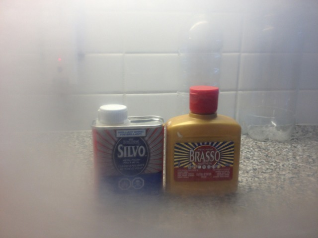

Wind visors were in rough shape so I gave them a clean
Order of operations
600 grit
1200 grit
Brasso polish
Silver polish
Turned out pretty great!

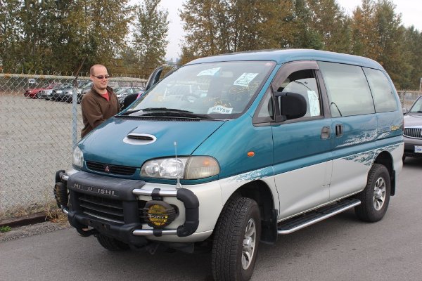

Picked it up at the WWL terminal and drove it home. There were some nice cars there - I especially liked a couple of the old school minis - and of course there were a bunch of L400's
