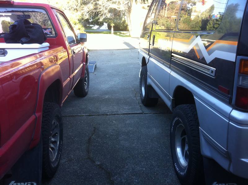

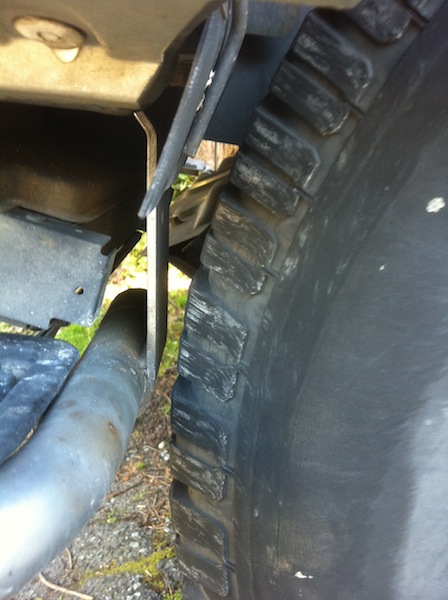

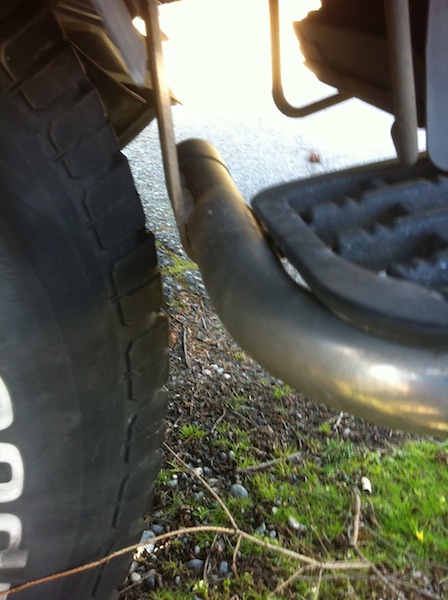

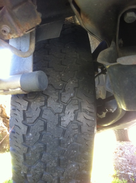

Here are some pictures of what the tires look like installed. I flexed the vehicle all around and nothing was touching but as the tread is at about 40% I'm wondering if the fact that the tires get quite close to rubbing will be an issue when I get new ones put on!?
I also attached a picture of what I'd like to do which is a straight-up swap of my Delica's rims and tires for those from my Boss' Might Max. Can anyone see why this would be a problem? He would just pay me for the tires as mine are only 6 months old and I would buy new ones for myself.

You'll rub with 31's on. In fact, you'll rip the front steps right off.
I had those rims on granola. They are American racing wheels 15x7 3.5" backspacing
See what they look like here : http://www.delica.ca/forum/expedition-d ... -2895.html
and on Turtle
You'll need to remove your front steps and trim the plastic front corner back a little and the rear of the wheel well you'll need to either cut or hammer the vertical seam at the lowest point.
These steps are pretty normal for fitting 31x10.5 tires with a 7/8" rim with 3.5 to 3.75" backspacing.
Mandatory is removal of front steps and mudguards with 31's and a 2" lift
and on Turtle
