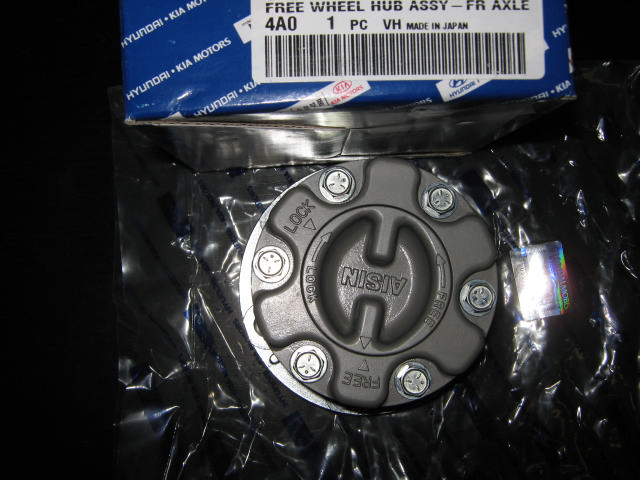

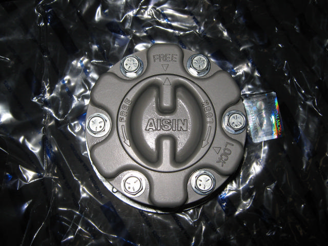

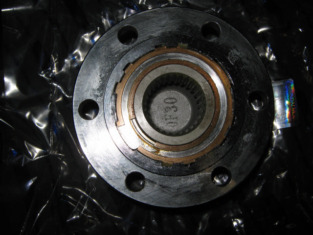

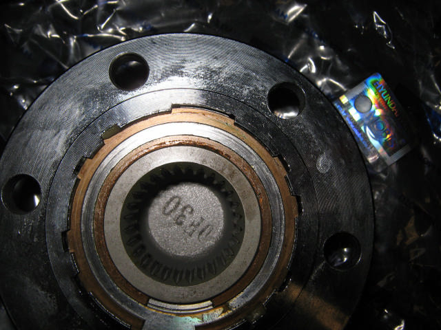

Partially not true in the quoted thread. We still can see original ones.jfarsang wrote:Superwinchkonadog wrote:anyone know where I can get a set of the Asian ones...?
AVM
Aisin copies
Dodge D50/Ram Aisin originals
Aisin stopped producing manual hubs over 5 years ago. What you see now are copies. The casting was sold to manufacturers in Asia. You can see them come from different countries.
You can tell the original from the copies by a vertical stamping on the outer ring gear. The Dodge D50's have them (one's with manual Aisin hubs from the factory).
The copies I've seen are as good as the originals, however the price is not. They are marked up to outer space.
http://www.delica.ca/forum/looking-for- ... 65-15.html
AVM hubs are as good as Superwinches but different casing. Average cost between $130 - 170 online retail.
Don't waste your money on copies that cost 2-3 times as much that give the same function.
AVM hubs are better lasting than superwinches and now are more widely available.
Part # 15001.43 AVM
http://www.summitracing.com/parts/RGG-1500143/
Hyundai regularly imported Aisin genuine free wheel hubs to Korea market and still have a few hundreds in stock from my source.
We can bring them anytime and group buy is welcome.
Don’t go for Aisin copies as they are really bad.
We have 4 units of Aisin ( made in Japan ) original in stock.
http://www.delica.ca/trader/item/119
Steven
**Anyone wants to see in person, pls visit my shop.
