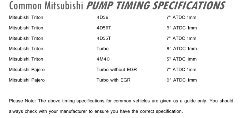

So where can we find the calibrating data specifications (everything a Mechanic need to know) about Timing our Injection Pumps ? Any link, PDF ?
EDIT:
As discussed in related subject, it is said at 9 degree in the cocument tough some say 7 ???

Have you checked the L300 Dedicated Technical Reference Library/L300 Shop Manual Downloads/L300 Engine/L-300 Fuel Delivery Systems Manual... Go to page 13B-1. ( viewtopic.php?f=116&t=7339 )
