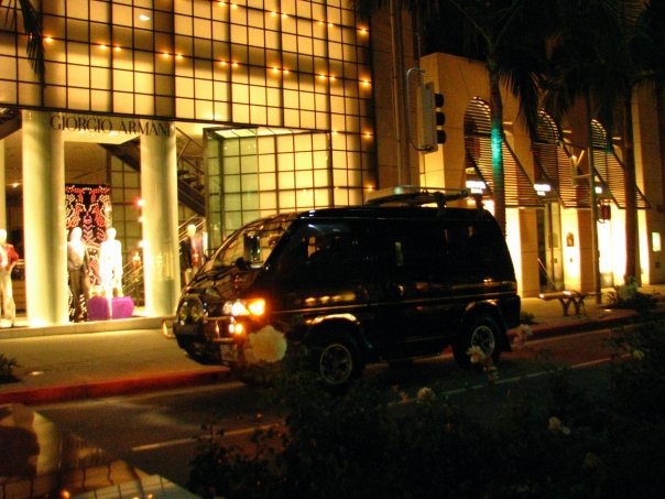

I brought mine to LA after Christmas. Before the trip, I finally got the chance to change my Timing belts and radiator as well. The deli drove very well up to San Jose for a stop over. It took us about 20 hours though as we were just going about 100kph max. 8-) Going uphill at 60kph max with accelerator pedal floored all the way, the big rigs just overtook us like we were on standstill. zzzzz :-( Oh well, we had the radio on so that helped a little bit. The delica had no issues on the whole trip...going up the Shasta Mountain and the Grand pass is no joke. It just drag drag drag all the way.
This is the fun part, Going back from LA to Vancouver, I floored that baby all the way and cruised it up to 130 kph ! :twisted: I figured Falco was right (If I'm going to hell, I'm going to hell with my delica !) I went to 140kph going downhill at times but maintained my 130kph pretty much whenever the road was flat. Mind you, we were 6 pig :oops: Adults in the van with a big Pallet Jack I brought back for the shop at the trunk. Boost was at 10psi 90% of the time ! Again....No issues! It performed immaculately. The only problem is the speed holes on my roof. The dealer who sold it to me took a short cut on it and just fiberglassed those holes instead of repairing it properly, it was literally raining inside the van with small specs of rusted metal ... so now, I gotta deal with that as well. hmph :cry:
I intend to do an engine rebuild this summer and do Headworks on the Cyl head to maximize airlflow and volumetric efficiency. Install new sleeves and piston rings on it, overhaul the turbo and partially blue print this power plant and see how it goes. I figure if I can put in an additional 20hp at least, it'll take those darn rigs up the hill (eat my dust kinda thing) ... :wink:

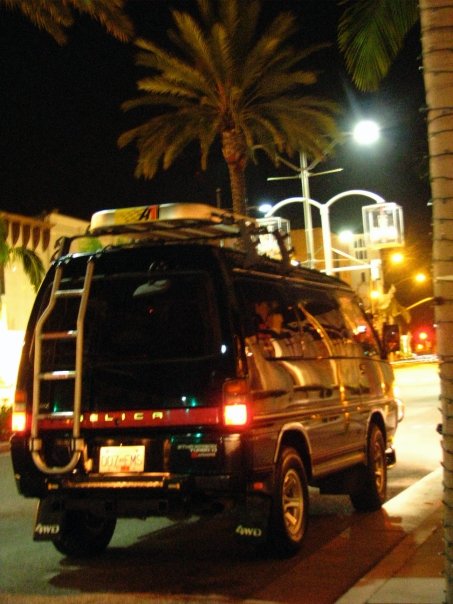

hey Nice pics, I was wondering... looks like your rear Delica lettering is lit up, so far I have only seen two Delica's that have this. Is it done aftermarket or is it just that most are non-functioning after 15 years use? Really would like mine to light up :)
Re: Are Delica's Crap?
Posted: Wed Jan 07, 2009 12:56 am
by bryanc
dfnder wrote:hey Nice pics, I was wondering... looks like your rear Delica lettering is lit up, so far I have only seen two Delica's that have this. Is it done aftermarket or is it just that most are non-functioning after 15 years use? Really would like mine to light up :)
Mine is lit up , definitely not after market and looks really cool :-D
