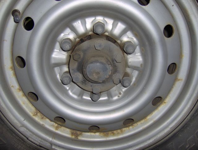

I have yet to hear any audible sound when shifting into and out of 4wd or locking and unlocking the hubs !
Every post i read has said you will hear a clunk click etc....etc... but on mine it is silent. I sure know it works though !!!

fishslapper wrote:I have yet to hear any audible sound when shifting into and out of 4wd or locking and unlocking the hubs !
Do your hubs look like this?:
flange hubs.jpg (46.41 KiB) Viewed 8239 times
If so you have hubs that are permanently locked so no clunking will be heard! :-D :M

While I have heard the sound, it's relatively rare, and usually while I'm pushing my comfort limits (ie engaging 4wd from the point of unlocked hubs when already stuck so there's no forward motion until the hubs engage) when your system is in good working order, and you use it without an overabundance of zeal (ie, don't throw the shifter and then floor the accelerator) it's pretty close to silent.
Those who describe their system as "loud" most likely have a maintenance issue of some form... maybe something needs to be oiled or replaced?
