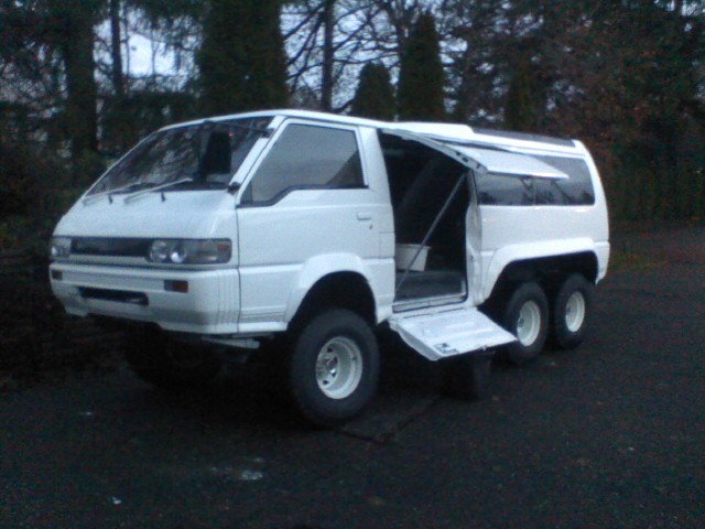

Re: Sliding door extension
Just do this, then no more hinge problems
(it will cost more than a hinge though)
- 1209101628a.jpg (78.67 KiB) Viewed 3199 times
