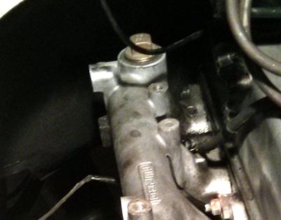

lrp374 wrote:2.Is the waste gate adjustment rod the same as the old engine?
It's in the same place, but the adjustment mechanism is slightly different. You can see it in the photo of the engine side- the adjuster has a stripe of blue paint on it (so they know if you've changed it. Which I have). It has a 10mm nut to lock it, and a knurled nut so you can adjust it by hand. ...while it's at a billion degrees because it lives next to the turbo. It's not the most considered design.
