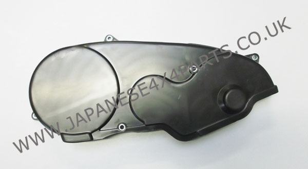

You should be able to check your timing without removing anything more than the top half of the timing belt cover, and you don't need to remove the fan or radiator.
Remove the five 10mm bolts and the cover comes free. Two of the bolts are longer than the others (but different lengths) so keep track of which long bolt goes in which hole. You *might* need to remove the drivers' side engine cover to get at the bolt on the far side of the cam sprocket- I can do it with the cover in place, but I know where the bolt is and have done it a couple of times.
If the timing is correct (check the link in my previous post to see how the timing marks should line up) then I'd remove the rocker cover and check for broken rockers, and that the camshaft rotates when the rest of the engine does. Turning the engine by hand, of course. Cranking the starter will spit oil everywhere

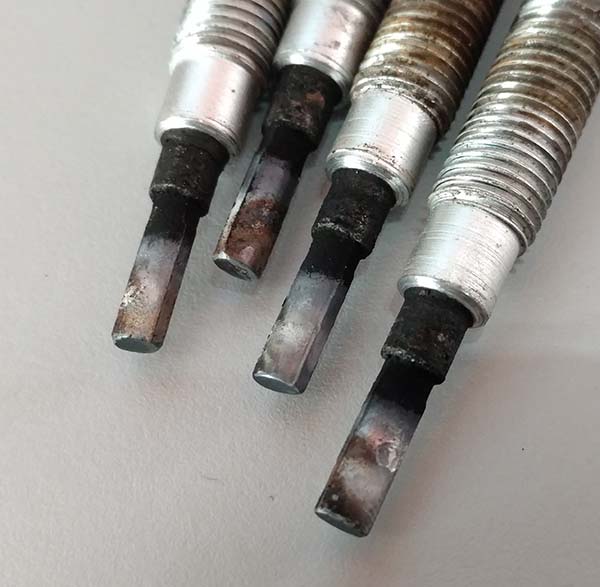

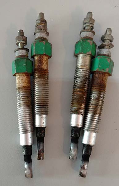

Pictures for reference.
Good news is the local dealer's got OEM avail from an East Coast (close to me) warehouse at about $30/ea. Part number is MD092392 as far as I can tell.

OMG you have no idea how relieved I am right now. Actually, on second thoughts, you probably do
. I was officially out of ideas!
There's a few reasons why this might be:
-The ECU measures the glow plugs' resistance to estimate how hot they are. Your old glow plugs might be fooling the ECU into thinking they're hot enough when they're actually not. Replacing the glow plugs is a good idea, but to avoid introducing new faults please make sure you're installing genuine Mitsubishi ones that match your old ones. It sounds like that's what you're doing (your part number is correct), but $30 is a suspiciously good price- they're usually US$40-60.
-The wiring between the glow plugs and the relays might be corroded or failing. Clean up the connections on that fusible link that was getting hot, and clean up the bus bar and any other connections you can find.
-The glow relay(s) might be failing, making a poor connection internally or with burnt-out coils.
-the ECU might be just not working properly- it's common for the circuit board traces to corrode due to overheating or a leaky capacitor.
There's an awesome thread here: http://www.delica.ca/forum/viewtopic.php?f=94&t=15336 , though re-winding your own relay coil is a bit hardcore. I'd just buy a new one if it comes to that.
Sounds like you figured it out but for others reading this: yes, just the positive side, from your own battery directly to the bus bar.pluckmyeyeout wrote:Before jumping the plug bar - Would I go from my own batt? And only the positive? Would I run the negative to the body of the vehicle somewhere?
If you increase the revs it should (might?) keep running- but investigating the glow plugs is definitely a good idea. For future reference: If there was an air leak in the fuel supply to the pump it would start and then stall out, but I would ignore that idea for now and fix the glow plugs.pluckmyeyeout wrote:I jumped the plug bar and it started right up! Just long enough for me to do a little jig, then promptly died.
Jumping the bus bar applies power directly to the glow plugs, bypassing the ECU and glow relays. So what we can say is that, for some reason, your glow plugs were not getting sufficient power when controlled by the ECU.pluckmyeyeout wrote:But what does jumping the bar tell us exactly?

You're using your multimeter correctly. The range sets the maximum resistance you expect to measure- so the 200 range measures from 0-200 ohms. For best accuracy, you set the range to the lowest setting you need- so in this case the 200 ohm range is right. 2.9 ohms sounds about right for a coil, and the coils look clean and unburnt.
Usually I'd measure from the spade terminal to the body of the relay, but I think the points you measured work out the same.
The ECU looks super clean. I'd bet the issues are all down to the old glow plugs being the wrong resistance.
