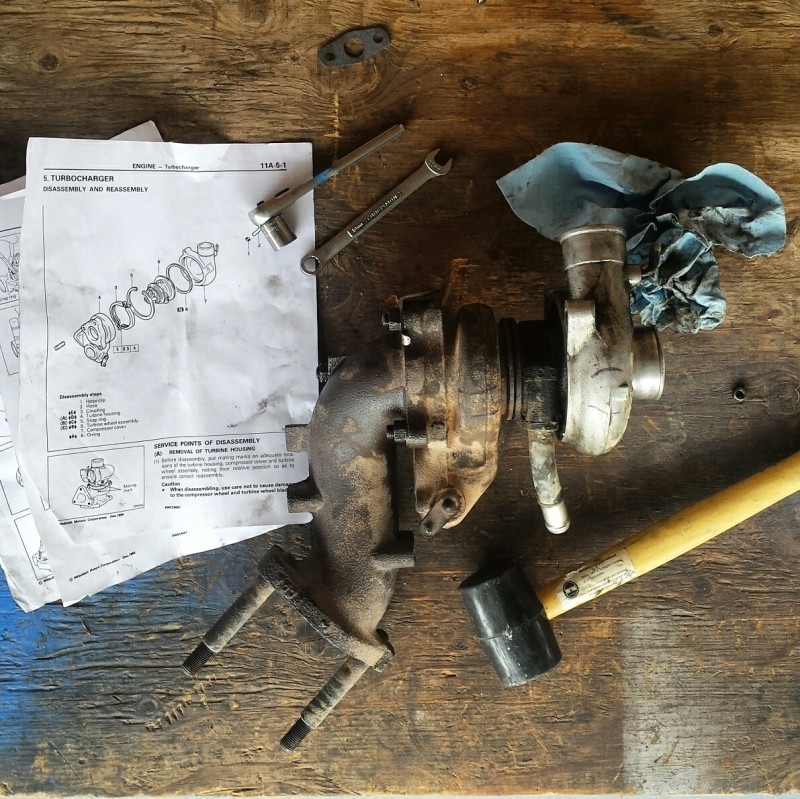

Also for anyone who is looking to do this rebuild I mentioned Rattlenbang's post earlier.
viewtopic.php?f=6&t=14171&hilit=td04+rebuild
A friend also found me an incredible rebuild step by step by David Roberts https://dproberts.files.wordpress.com/2 ... manual.pdf
It wasn't the same turbo as mine but it was only minor differences and was very helpful.

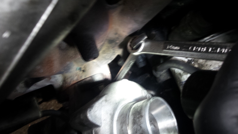

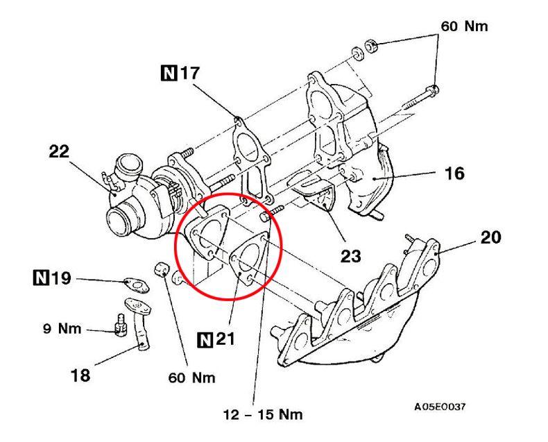

One thing that I was able to do was get the turbo off at the exhaust manifold, not a having to take off the whole shebang
This required taking off the lower heat shield (23) to get at the back bolts and attaching a cheater wrench to a 14mm to very incrementally loosen the front nut. Oh and a decent amount of liquid wrench (the stuff smells terrible but it works small miracles)
Optimized-Cheater wrench.jpg (176.49 KiB) Viewed 3356 times

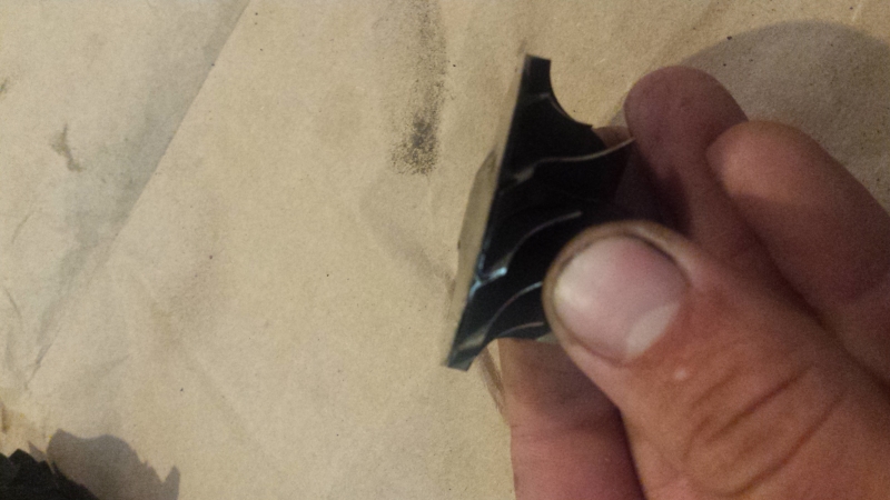

I also had a Superback turbo which was noted on my turbine housing but here's a picture of my compressor wheel with the non flat back ie. a superback.
