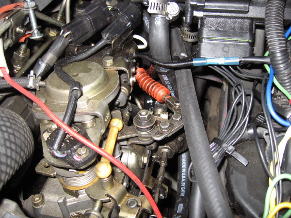

My deli rides again! As I was preparing to change the fuel filter I noticed that an electrical wire that runs from the top of the injection pump to a conduit at the battery was no longer connected. I thought that to be strange so I reconnected using a new coupler. My battery was still dead so the next day we pushed it out of the driveway and boosted it. Instant start, no RPM reduction. I am guessing that the wire in the picture that has the blue coupler was a power one. I wasn't getting any lift.
I did not get the new fuel filter installed but will tackle that next. It is so awkward with the 6 port veg valve in the way. I think I might have stripped the little screw in the top of the filter. So I should take it out before I do the filter change. Thanks for all the input. Every problem builds our knowledge base of our wonderful Delicas.
