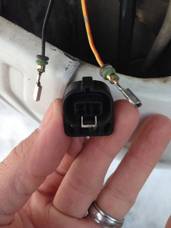

Side markers wouldn't work because the polarity was backwards (thanks to LeeHammy and yojimbo for the help) but the fix was easy. Take the wires out of the holder and switch them. Problem solved.

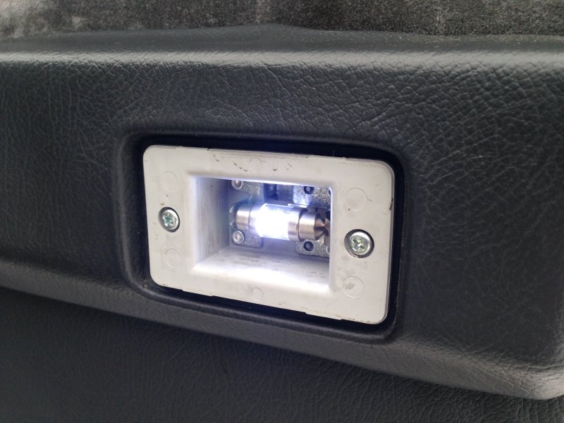

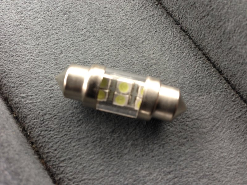

10x 31mm festoon bulbs. Only needed 8 but came in a pack of 10 (2x dome, 2x map, 2x door, 1x sliding door step, 1x 3rd row seat dome)

LED's
31mm festoon.jpg (101.94 KiB) Viewed 21267 times
rear dome.jpg (59.34 KiB) Viewed 21267 times

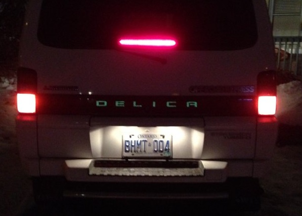

You missed some. I changed my DELICA lights to led :)

yojimbo wrote:You missed some. I changed my DELICA lights to led :)
There's no way i'm pulling that off...unless they burn out :? They're good for now.
Re: nvanadm's Derelictica
Posted: Tue Dec 03, 2013 12:51 pm
by yojimbo
Hehe, they are replaced from behind the tailgate trim panel inside, its actually fibre optic out to the panel letters. Still a faff though.

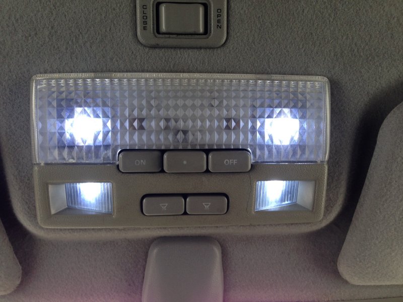

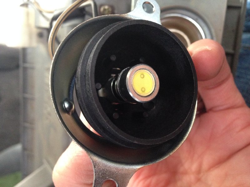

More LED's...

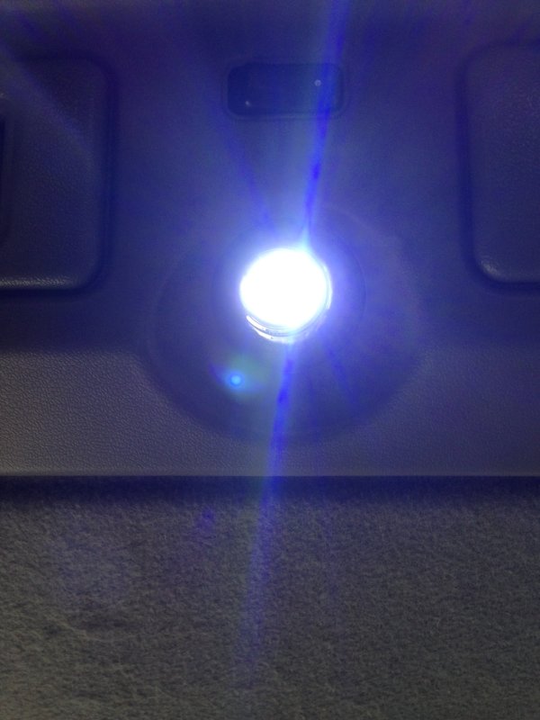

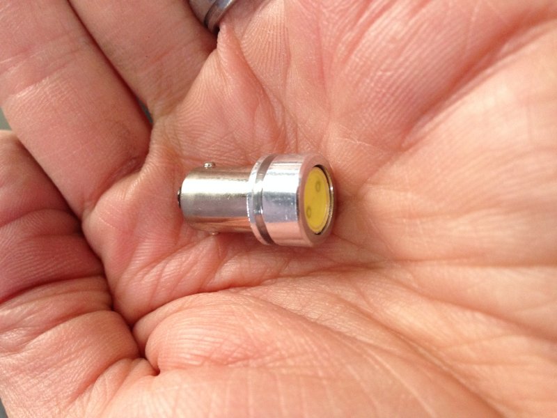

I finally found the LED light that fits into the reading spot light in the back.
It was on eBay as BA9S 1D 0.5W mini. $1.36 for two and free shipping. Can't beat that!

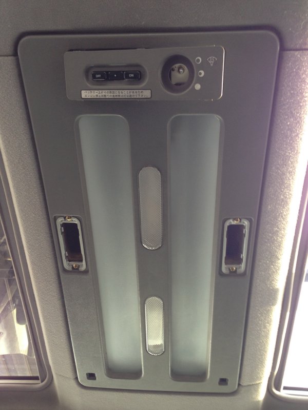

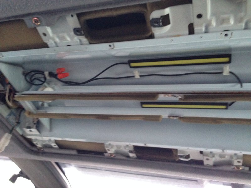

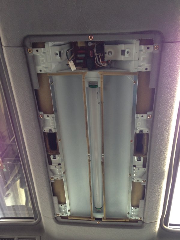

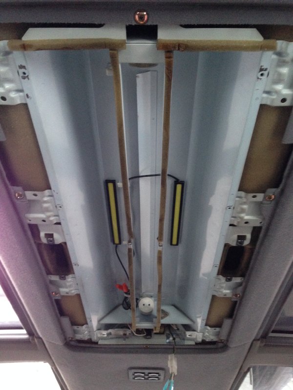

Also decided to buy some LED COB strip "DRL" lights to replace the 20W bi-pin fluorescent bulb. The LED's are 6W each.
First had to remove the covering.
center light.jpg (61.46 KiB) Viewed 21179 times
center light2.jpg (69.19 KiB) Viewed 21179 times
Snipped the wires going to each end of the bi-pin connectors. On mine the grey wires were negative and the white wires were positive. Then installed the LED's with the 3M strip and wired them up.
center light LED.jpg (74.69 KiB) Viewed 21179 times
center light LED2.jpg (74.92 KiB) Viewed 21179 times
Center light LED3.jpg (27.46 KiB) Viewed 21179 times
Pretty easy to do.
Posted: Sat Jan 11, 2014 2:07 pm
by lrp374
Does the dimmer still work?
Looks like a nice install and more light!!
Posted: Sat Jan 11, 2014 2:17 pm
by nvanadm
lrp374 wrote:Does the dimmer still work?
Yes, kind of... High lights them both, Medium does nothing, and low only lights one. Works for me.

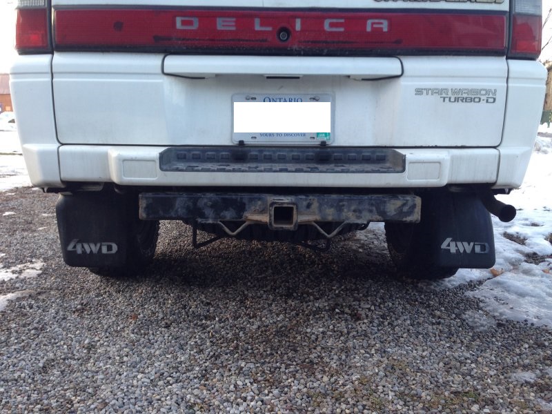

Finally got a hitch. Bought it used here on Delica. It's a factory hitch so I just needed to take the chrome bumper off and put the hitch on. Took 20 mins.
Shipping from BC to ON was $75, but it only cost $125 so it was a cheap hitch overall for $200.
Going to remove it in the spring and clean it up, but I wanted to just get it out of my living room for now.
I'm not planning on towing anything with the hitch. Just wanted it to mount a bike rack.
