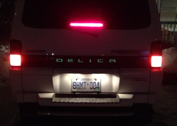

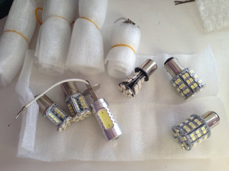

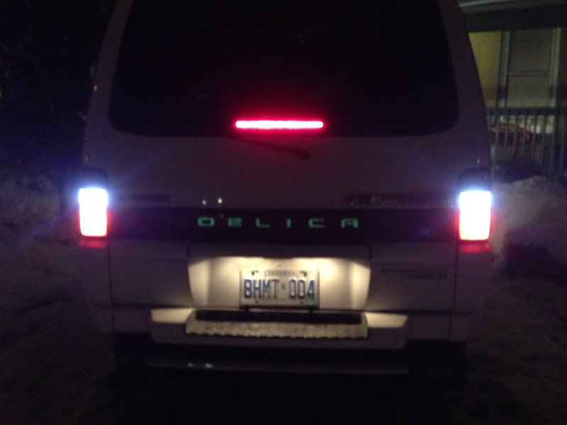

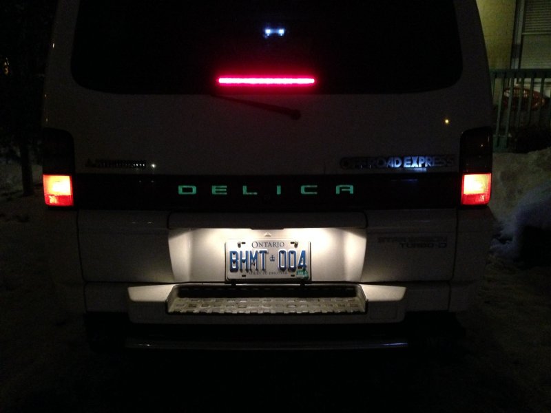

LED Lights:
Finally got all my LED lights in. The total cost was about $70 for (almost) all interior and exterior bulbs.
I bought:
8x 1156 (rear reverse x2, rear turn signals x2, front fog x2, front turn signal x2)
2x 1157 (rear brake lights)
With brakes off.
brakes off.jpg (46.06 KiB) Viewed 21268 times
With Brakes on. Quite the difference.
brakes on.jpg (50.24 KiB) Viewed 21268 times

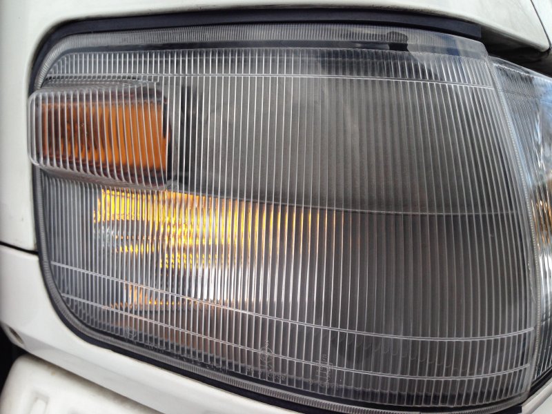

2x 1156 amber (side markers)

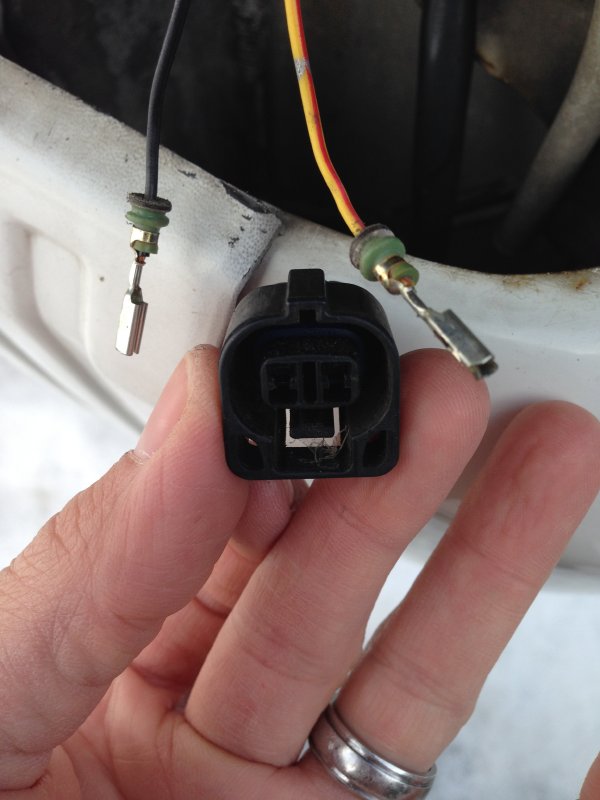

Side markers wouldn't work because the polarity was backwards (thanks to LeeHammy and yojimbo for the help) but the fix was easy. Take the wires out of the holder and switch them. Problem solved.
side marker3.jpg (57 KiB) Viewed 21268 times
side marker5.jpg (113.44 KiB) Viewed 21268 times

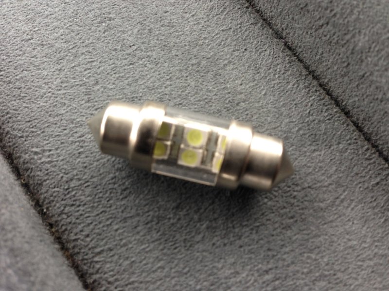

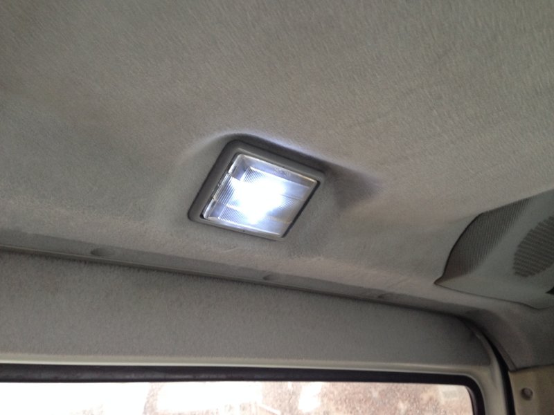

10x 31mm festoon bulbs. Only needed 8 but came in a pack of 10 (2x dome, 2x map, 2x door, 1x sliding door step, 1x 3rd row seat dome)
dome and map.jpg (85.41 KiB) Viewed 21268 times
nvanadm
Posts: 439
Location: Canada
Re: nvanadm's Derelictica
Post by nvanadm »
LED's
31mm festoon.jpg (101.94 KiB) Viewed 21266 times
rear dome.jpg (59.34 KiB) Viewed 21266 times
Night pictures of the front LED's to come.

You missed some. I changed my DELICA lights to led :)

Hehe, they are replaced from behind the tailgate trim panel inside, its actually fibre optic out to the panel letters. Still a faff though.

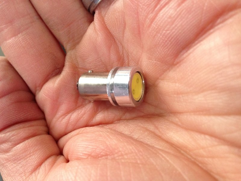

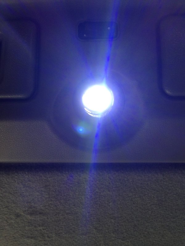

I finally found the LED light that fits into the reading spot light in the back.
It was on eBay as BA9S 1D 0.5W mini. $1.36 for two and free shipping. Can't beat that!

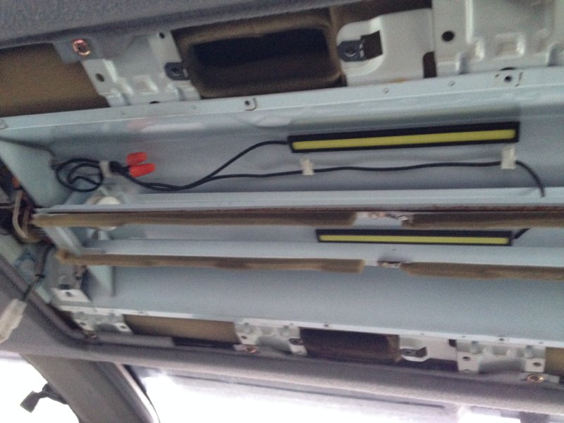

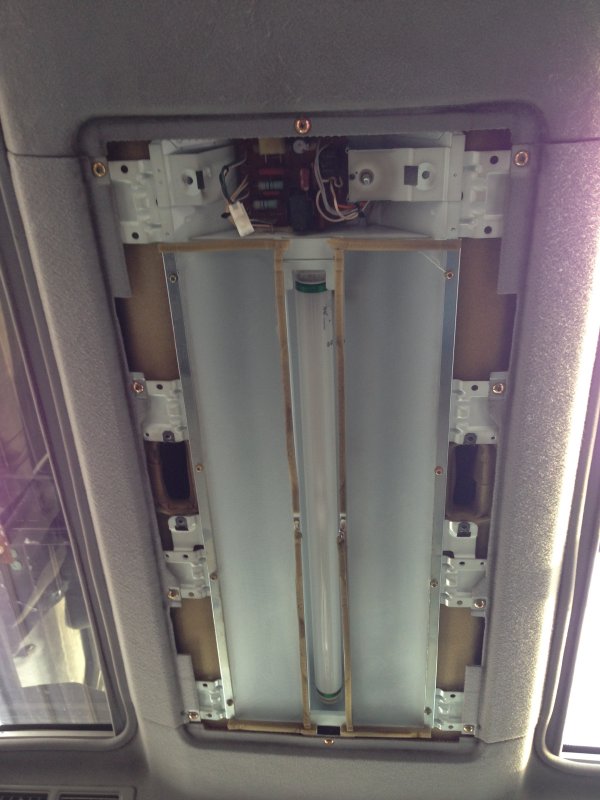

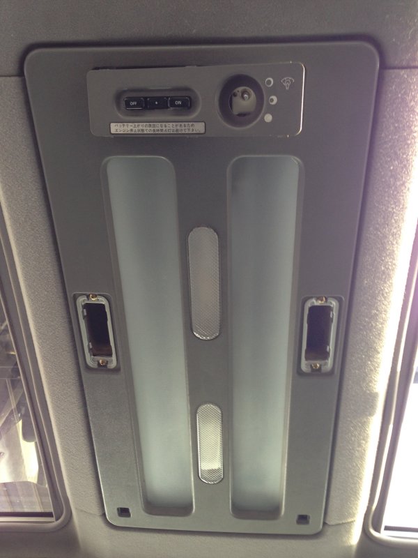

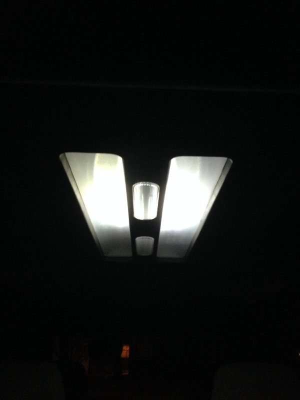

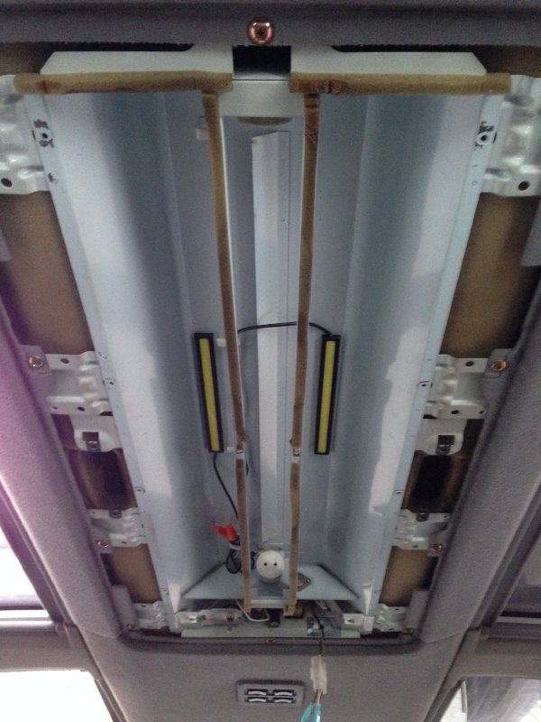

Also decided to buy some LED COB strip "DRL" lights to replace the 20W bi-pin fluorescent bulb. The LED's are 6W each.
First had to remove the covering.
center light.jpg (61.46 KiB) Viewed 21178 times
center light2.jpg (69.19 KiB) Viewed 21178 times
Snipped the wires going to each end of the bi-pin connectors. On mine the grey wires were negative and the white wires were positive. Then installed the LED's with the 3M strip and wired them up.
center light LED.jpg (74.69 KiB) Viewed 21178 times
center light LED2.jpg (74.92 KiB) Viewed 21178 times
Center light LED3.jpg (27.46 KiB) Viewed 21178 times
Pretty easy to do.

Does the dimmer still work?
Looks like a nice install and more light!!
nvanadm
Posts: 439
Location: Canada
Post by nvanadm »
lrp374 wrote:Does the dimmer still work?
Yes, kind of... High lights them both, Medium does nothing, and low only lights one. Works for me.
