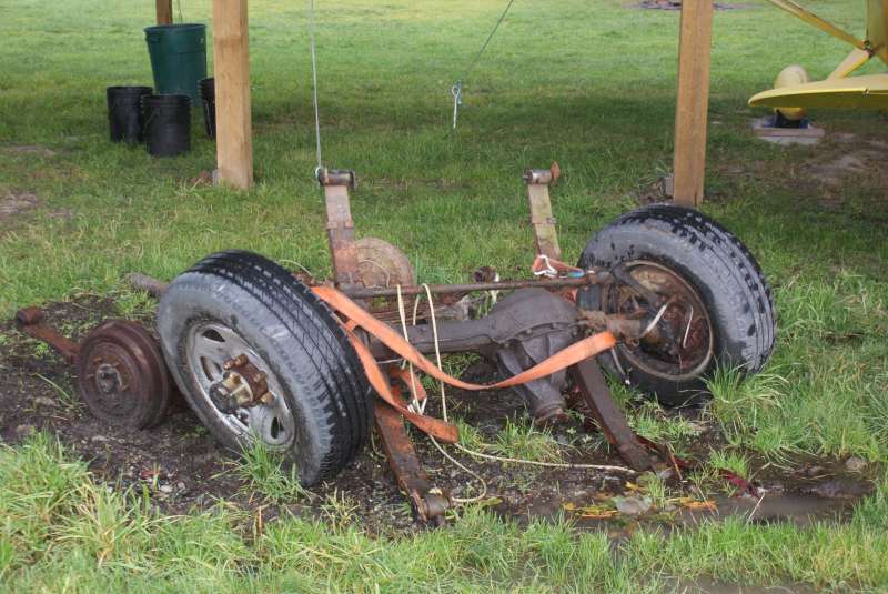

Current state of the SAS is as pictured. I will be holding of until I get me nwe engine and do the engine swap and SAS at the same time..

There seems to be a complete lack of a vehicle in that image.Super Exceeded wrote:Current state of the SAS is as pictured...
What's the timeframe on an engine? Also, what's an "nwe" engine?

yum. how's the axle/cv condition on the donor axles?

The axles look in great shape, but will tear them down and have a good look.
