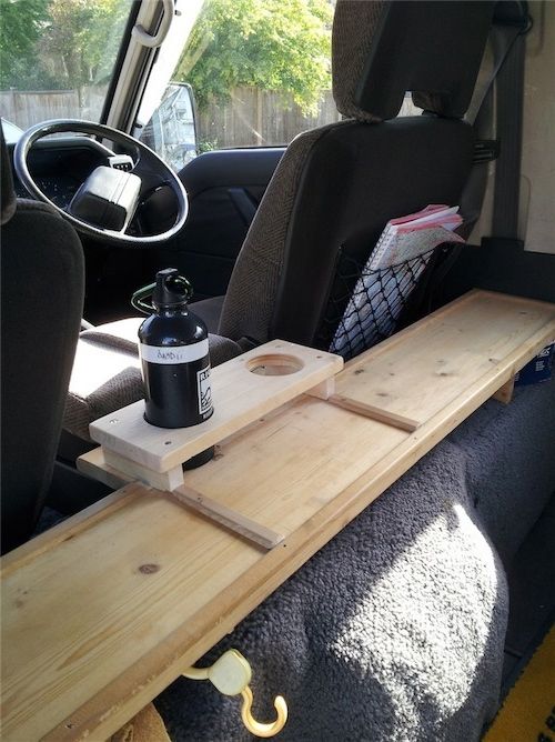

I managed to finally add center-cup holders to my "behind the front seat" counter. Also added a few strips of moulding so the tissue box will stop sliding every time I turn a corner.

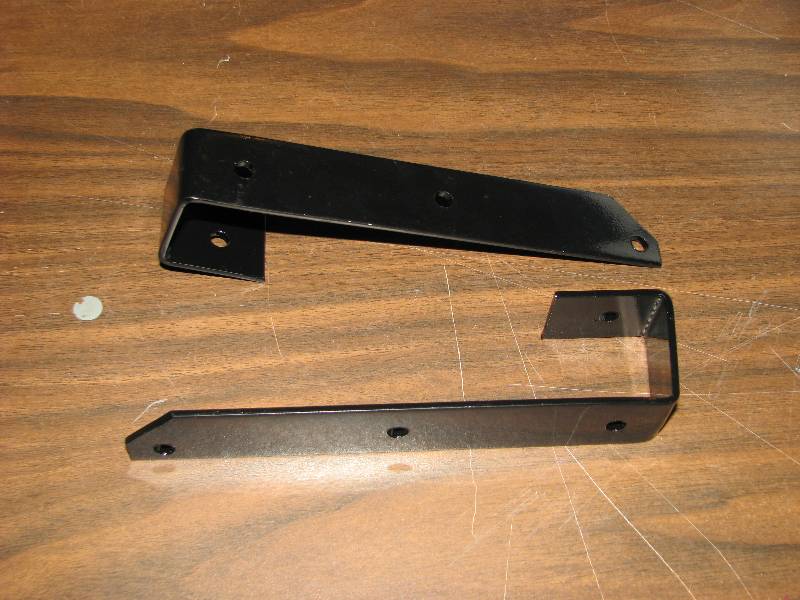

I finished fabricating some brackets to hold mudflaps on the rear wheel wells. Used a cardboard template and bent some steel, drilled some holes and gave 3 coats of tremclad.

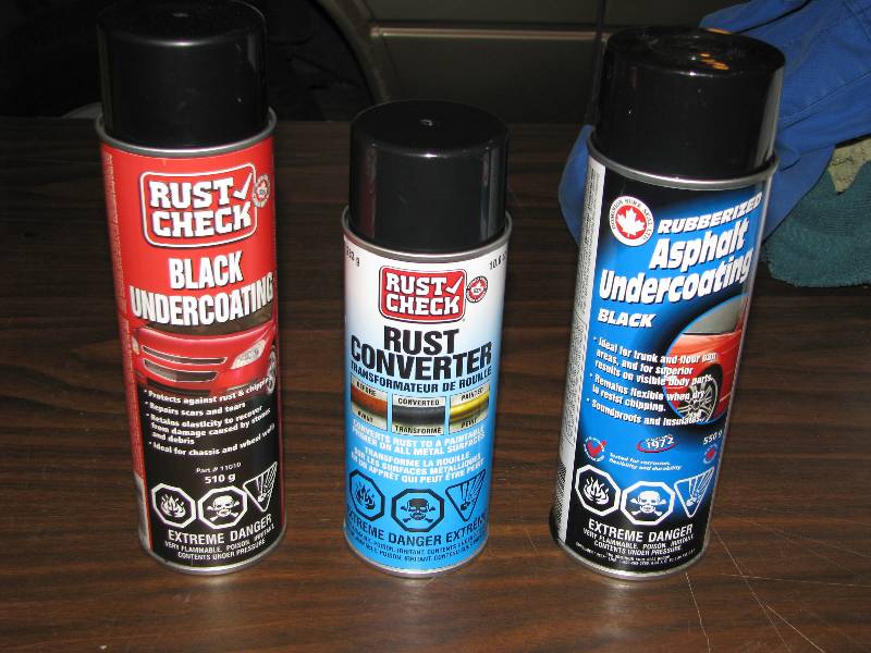

Hey, I have noticed some surface rust forming in the rear under and around the spare tire. I want to get rid of it so what are your thoughts on these products? I was thinking zap it with the rust converter and then use one of the 2 types of undercoating crap. Thoughts? Product reviews?

I would use the same product so you know they are comparable, but I would throw a layer of paint over the rust converter then over the undercoating a good layer of Fluid Film
Then you would have your total protection

In my experience rust converters etc only ever really attack the surface layer, so either sand/wire brush it down so its a very thin layer of rust, or por 15 it, which seems to work even on thicker rust.

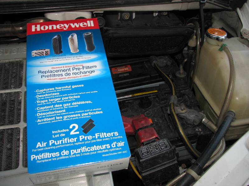

Made myself a cabin air filter. Remember reading here a while ago about them being non existant and got tired of the used dryer sheet I had been using always falling out when I popped the hood so I came up with a little invention. I purchased some new charcoal prefilters for our bedroom air purifier from London Drugs and realized they would work great to replace said dryer sheet. $15 (enough in the box to probably make 4 or 5) and 4 of my wifes bobbie pins to hold it in place. Works well.
