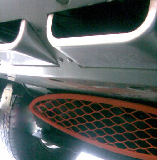

the guy next door to has a chamonix so i will try to fit it to his and get to the bottom of this !
It has fit every vehicle perfect so far except for that 89 model year one and now this chamonix. Was the 89 a chamonix model as well ??
cheers isaac
cheers isaac

I've got a Chamonix.
David I can pop by tomorrow and test fit.

I'm guessing it does fit, but that the tricky front left anchor bolt is the issue. When I mount another plate on my next deli
I will poke a pointy thingy (punch, scribe, bit-o-wire, etc.) up through the bolt hole and either stuff my arm in the other side like I did this time (this way must be done before the plate is lifted into place), or finesse with my fingers on the same side, the washer and nylock nut over the pointy thingy so that they align with the hole. This is basically what I did, but without the pointy thingy as a guide. Then carefully trap the bolt with my fingers while I lift the plate into place, insert the bolt and catch the threads of the nut. After that it's easy enough to trap the nut with a spanner and cinch it tight. There is something (A/C bit, maybe), right above this hole too, so the bolt can't extent much beyond the topside of the nut. Anyway, I'm betting the Chamonix is the same as all the rest... Very interested to hear the outcome.
Just LOVE this skid-plate btw. I think it looks like it's been there all along...

i looked next door and what i found is this....
The chamonix versions have the stamped steel pan that goes under the front between the bull bars omitted. I guess they figured that because the
chamonix came with a half skidplate That they did not need the other plate under there as well !! So i bet you could source a plate from glenn or mardy if you really want
one of my skidplates. The bolts that go into the bottom lip of the air scoop are the same so no issues there.
Sorry......i never thought it would be an issue since those of you with chamonix are usually bragging about the plate under your vans !! hahahaha.....
so if you are on the list and have a chamonix let me know so i can work something out with you.
isaac
isaac

The '89 is not a Chamonix and I haven't got that picture that I promised yet.

hey David! I must have a very special deli for my plate will never fit under it's actual shape!!!
It seem that I have a different scoop under there (definitively different than the picture on page 16
) we should meet sometime next sunday (butch will have it on saturday) anyway, it might be the same thing for the chamonix??????
