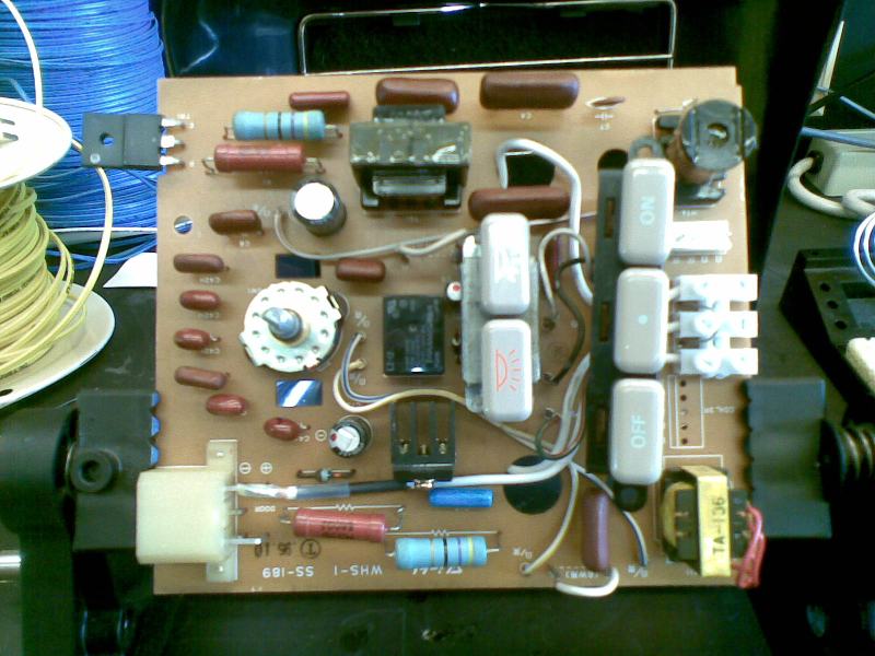

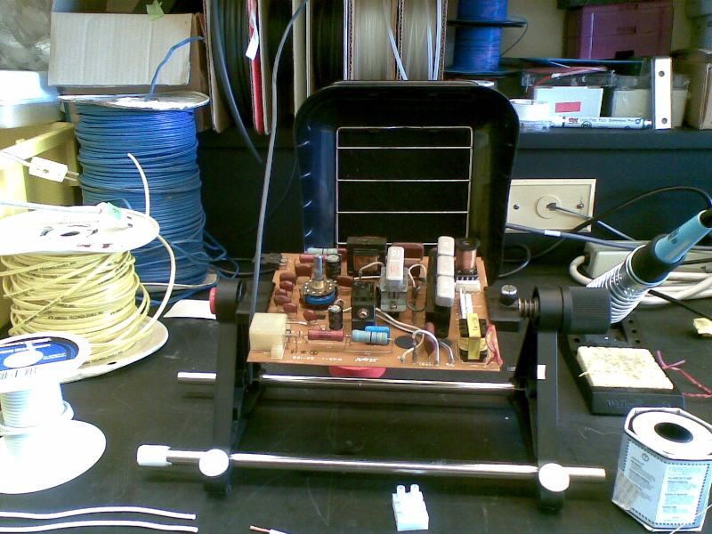

Rewired the rear L400 RED/WHITE flourescent controller to use LED strips instead of the gimpy flourescent tubes. Credit for the idea goes to Diver from his post on the UK Delica site.
The operation was simply remove a couple of the original connector strips to make room for a terminal strip. Cut + power from board and wire direct to terminal strip. Then run a - wire from each of the - terminals from the switch to the terminal strip to do the switching from sexytime red or business white. Check out Divers post on the UK site for more pictures of where to do what. I used 4 strips of white LEDs and 2 strips of red LEDs
You could be more creative and rewire to use the dimmer switch etc but I just wanted simple ON or OFF of either the white or red LEDs. Plus I only had 15minutes on my coffee break to git'r'dun.
Here are a couple pics of the mods to teh board. Pics in the vehicle to follow sometime...
Before
Before
After
After
