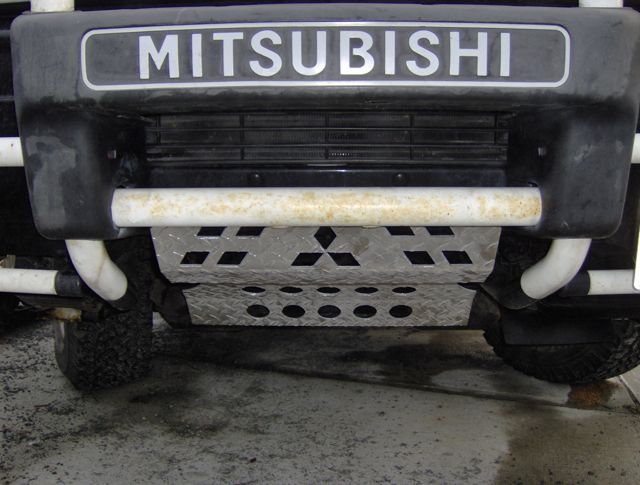

Re: Skid plate, pictures...
Posted: Tue Jan 13, 2009 10:19 pm
by shaun
Thanks Isaac for putting my plate on,fits good.I'll move the a/c filter up & out the way later.
Posted: Wed Jan 14, 2009 10:24 pm
by FalcoColumbarius
Looks really good, Shaun. Nice pictures, too.

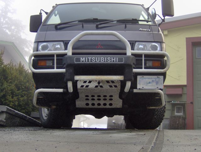

We were planing to go to Victoria this wknd and to pick it up at ccautos on the way though, but Nellie-dog barfed all down the inside of the bus between the bench-seat and the wall just as we left the driveway :shock: Oh Gawd, what an epic - out with all the stuff, the seat had to be unbolted and dragged out and the floor had to come up and the wall vent removed - 2 1/2 hours later and we were ready to go again, but little dog was still sick (all night too :-( ) so we aborted / postponed the trip. I emailed Glen to let him know we would no longer be popping by and a few minutes later he replied saying he would be delivering a Pajero to Courtney in the evening and would bring my plate along if I cared to motor down and meet him. Happy day, I get my plate and still get a little trip in the bus! I felt like Philip Marlow at a stakeout as I waited at the foggy rendezvous under the Hwy. overpass watching for a Pajero coming my way; the only thing missing were the cigarettes, the bottle of whiskey, and the .38 in the glove box 8-) Thanks again for delivering it Glen, much appreciated.
So this morning I got out there under the bus and bolted it on. It was a little tricky, but not too bad. I ended up removing the rubber strip along the base that is held on with 8mm bolts so the plate lies flush and not on the little bolts. The attachment bolts on the driver's side were a piece of cake, but the passenger side were more work, esp. the one at the front. It took a little finessing and careful pre-placement of the washer and nut inside the upper pan - and several attempts... :? but it's all bolted on and ready for those nasty pointed sticks and brush! Thanks again to all involved in the design, production, and delivery of these things - It's great so many of us have them now - kinda like a mitsumaple or delica.ca sticker! :-D
Posted: Sat Jan 17, 2009 11:01 pm
by FalcoColumbarius
Nice picture, Kona.... Looks skucum on the mighty Hazel 8-) !
