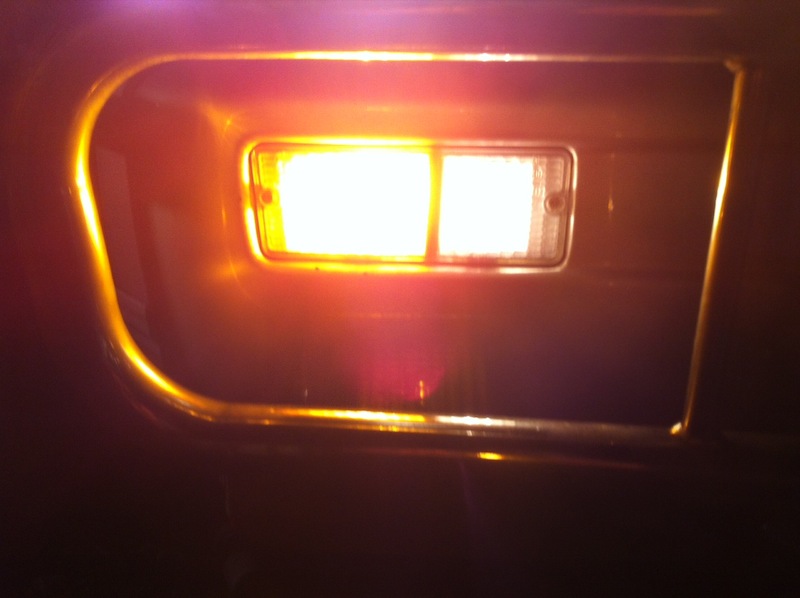

Re: Hermione's Makeover

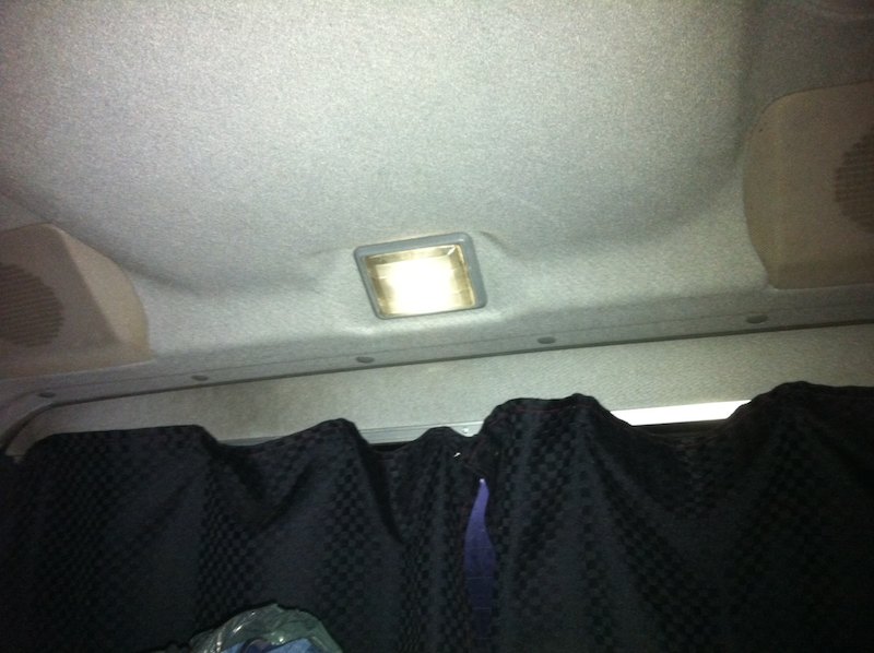

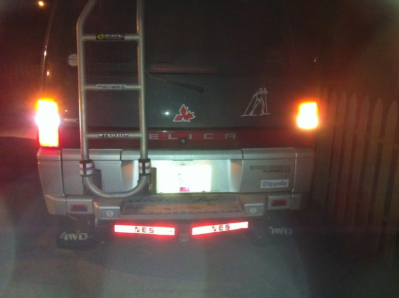

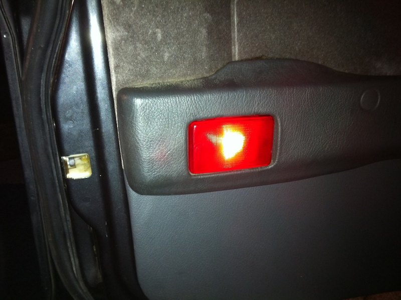

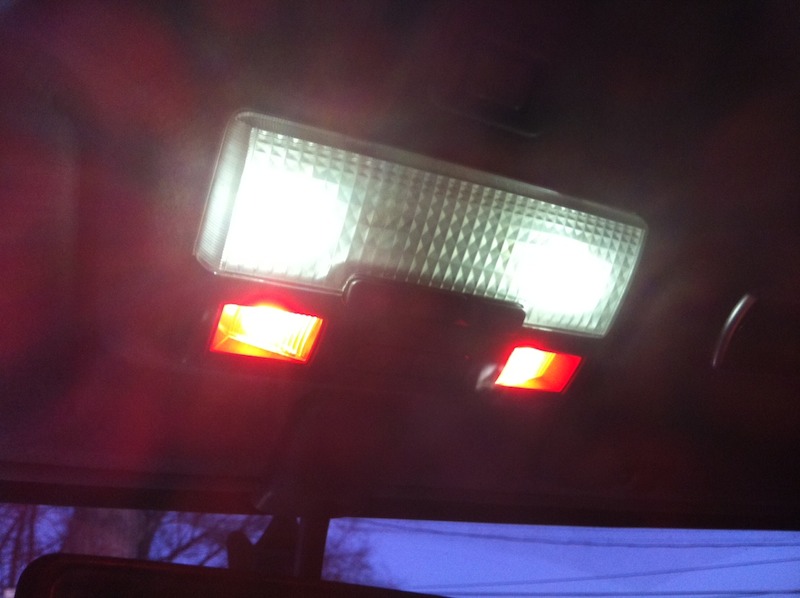

I've replaced almost all of my light's with LED's and it's a big improvement!
- lights-1.jpg (77.19 KiB) Viewed 4786 times
- lights-2.jpg (77.08 KiB) Viewed 4786 times
- lights-3.jpg (76.4 KiB) Viewed 4786 times
- lights-4.jpg (77.45 KiB) Viewed 4786 times
- lights-5.jpg (75.5 KiB) Viewed 4786 times
- lights-7.jpg (74.98 KiB) Viewed 4786 times
- lights-8.jpg (76.17 KiB) Viewed 4786 times
Looks good. Did you keep the stock mini-horn or upgrade it to something American's will hear ?
Still with the mini horn.
I actually don't find it as quiet as everyone keeps saying.
