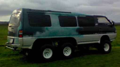

Got 33's X 12.5 on mine with a 5 inch lift!
But you all knew that.
And yup, they're all right, going past 3 inches bring lotsa head aches
- a1022100958a.jpg (6.59 KiB) Viewed 4870 times
Re: Tire size with a lift
He's out to lunch (current seller parting it out). It's a 2" lift. I should know as I installed it when I owned it.nxski wrote:That was one of the things I was wondering about. It seems pretty labour intensive. When I sent an email about the lift I was told it was between 4 and 6 inches but it looked more like a 3" lift. I think I'll keep shopping around. I can't afford to buy yet and it seems that the cheap Deli lift will soon be a thing of the past.
Jezoos man ! How on earth is that little engine pushing 6 meaty tires ?! I have to admit. It looks verySuper Exceeded wrote:Got 33's X 12.5 on mine with a 5 inch lift!

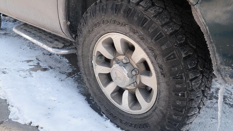

Hi, just about to get a 2" lift kit installed next week. My existing rims are 15"x7" and if I measured correctly the offset is 4 3/4".
Will that offset still allow me to install 31x10.5x15 duratracks or will they rub on the inside of the tire? I've read that 3 3/4" is the minimum back offset, whats the max?
- IMGP0943res.jpg (75.61 KiB) Viewed 4529 times
I haven't tested 4.75" backspacing on a 7" wide rim with 10.5" wide tire.
You won't know if it rubs unless you fit it.
I know on an L300 10.5" tires on the stock 6.5" rim does run the upper control arm on the inside of the tire. I believe the stock rim is 4.25" backspacing.
