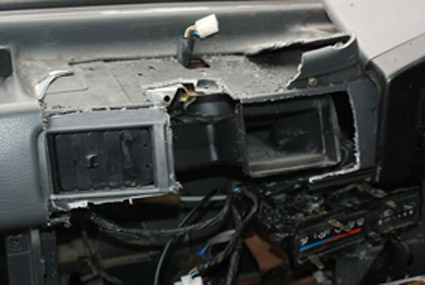

Re: L300 Stretch updates
Started to rip out the center section today. This WILL BE a bigger project than I expected!

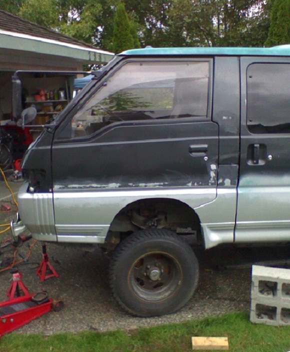

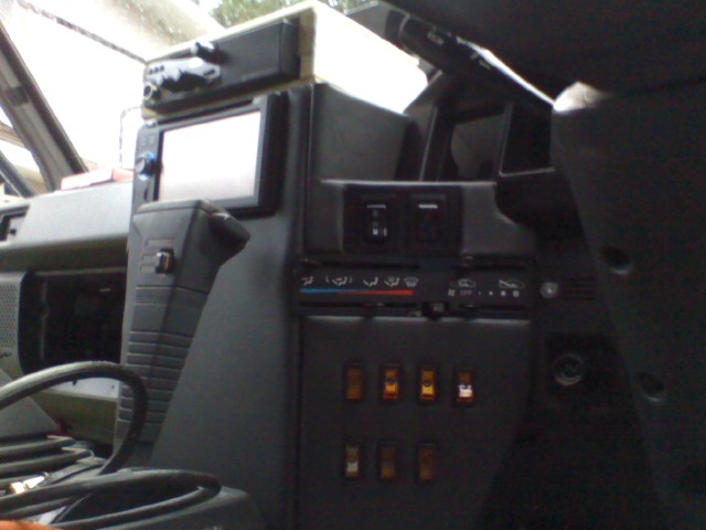

Been a little quiet as it's taking a lot longer than I expected. (finding parts mainly, we're having to machine a lot of goodies). But the front lift is now in. And no those are not the tire(s) that will be on the truck when finished, and yes, it is currently on backwards.. All will be clear soon. Center console nearly finished as well. Here's a little peek.

Nice work! Look forward to seeing the finished product.
As I'm on the hunt for a new head unit and looking at all kinds of options, what did you settle on? Looks like a Pioneer? What is the unit above it...CB?
